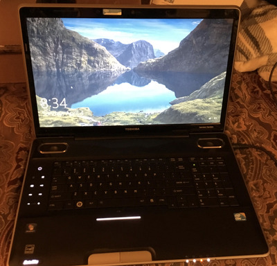

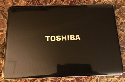

My sister had a Toshiba 17” Satellite for a few years but had to trade it in for a smaller laptop as it was to BIG to be mobile.
I was at a local used computer reseller store and found this “Gloss Black Toshiba”
This thing is a Cadillac. An 18” Satellite load with Harmon Kardon 2.1 audio.
It a real beauty with Aluminum keyboard. Executive class laptop.
