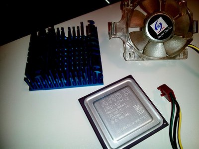

Here's my CPU:
239.75 KiB
2770 views
I guess 0021 is the date code?? 21st week of 2000? Am I reading that right?

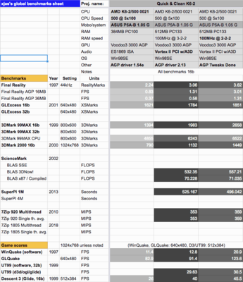

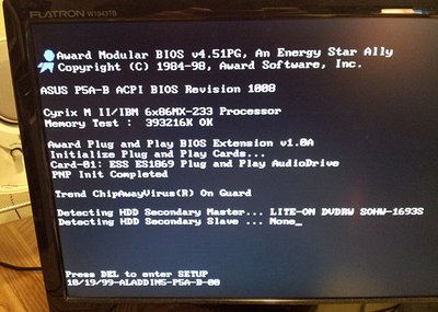

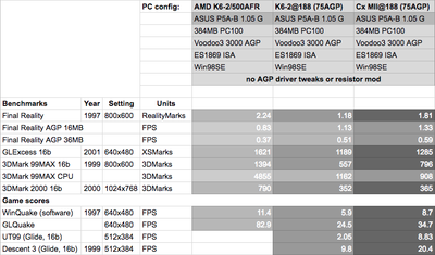

Reply 32 of 38, by xjas

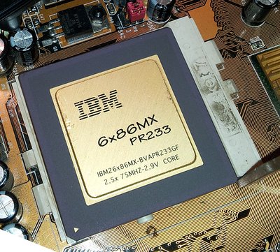

Well that was interesting ... I tried to do some investigation & benched my K6-2 against a Cyrix MII/PR233 (the closest thing I have on hand to another K6) at exactly the same bus speed and multiplier, 2.5 x 75 = 188MHz, as per the Cyrix. Clock for clock the Cyrix beat the K6 in nearly everything, except 3DMark 99MAX's CPU Mark, which is probably benefiting from 3DNow.
92.26 KiB
2726 views
I didn't do ANY changes in the BIOS/drivers or jumper settings between the two CPUs except the voltage. It definitely seems like my non-Plus K6-2 is triggering the bug. Check out those Unreal and Descent 3 scores.

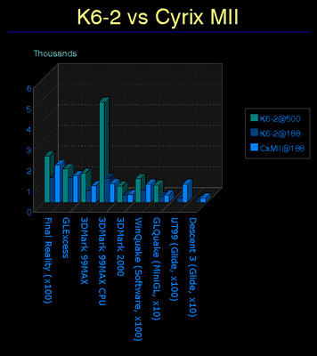

If that's annoying to read, I even made a chart:
13.44 KiB
2726 views
The K6-2 at 500 is definitely faster, but it doesn't seem like 2.5x faster, and the Cyrix at 188 nearly caught up in some applications.
302.04 KiB
2726 views
153.83 KiB
2726 views
Incidentally my Voodoo3 runs like a champ at 75MHz (albeit with a little extra fan blowing on it); the system is rock solid with the Cyrix & pretty quick for what it is. I might keep it installed until I can find a non-bug-triggering K6 or a good enough soldering iron to do the resistor mod.
Does the resistor mod completely mitigate the bug?
Reply 33 of 38, by xjas
Bumping this back up. It appears my K6-2/500 with date code 0021 (late May, 2000) is NOT affected by this bug. I was able to see huge gains by installing the right AGP driver, tweaking the hell out of it, and using some faster memory. Knock on wood, but I'm extremely pleased with the performance I managed to get. My "final" 3DMark 2000 score is 1449.
So either not all late non-Plus CPUs got the instruction change, or it doesn't affect them for some reason, or I have a mythical non-bugged revision G chip on my P5A-B 1.05.
I did my thing again (ran a whole pile of benchmarks and put them into a spreadsheet.) Here are the results:
56.61 KiB
2665 views
Note that there's a complete Windows reinstall & sound card swap, along with an upgrade to a matched pair of PC133 RAM, between columns 1 and 2.

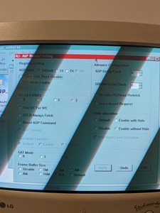

I saw huge gains just by upgrading from the ASUS-supplied version of the AGP driver (v1.54e) to the 2.13 unified, and even more from tweaking the settings. (The 2.20 unified pack from Vogonsdrivers wouldn't install.)

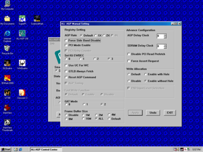

Here's the final AGP settings I settled on:
33.29 KiB
2665 views
The biggest gains came from enabling Write Allocation and K6 EWBEC -> 3 (which I set at the same time.) The other stuff had very little effect, although GAT Mode seemed to net me a couple FPS. Changing the RAM timing from 3-2-2 to 2-2-2 for the final run of benchmarks gave a tiny but measurable boost.

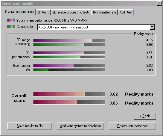

Check out the improvement in bus transfer rate in Final Reality! Exactly the same system specs, only the driver tweaks above applied:
10.31 KiB
2665 views

Reply 34 of 38, by xjas
BTW, in case this is helpful, I found this article from a Chinese magazine where they go through all the driver settings in detail. I had a hell of a time squeezing this through Google Translate & having all the images show up, so I made a (long!) png capture of the whole thing. It's not too bad to read, surprisingly.
534.2 KiB
2664 views
Here's the description of all the settings in the AGP utility from elsewhere on the same site:
ALi Yangzhi chipset motherboard AGP Utility tool latest version 1.40 For Win9x/ME/2000/XP (released on August 31, 2001) Yang Zhi […]
ALi Yangzhi chipset motherboard AGP Utility tool latest version 1.40 For Win9x/ME/2000/XP (released on August 31, 2001) Yang Zhi can always come up with some practical tools, which really makes everyone like it, they introduced earlier The ability to improve disk performance through settings is the IDE Cache Settings Center. This time we are seeing their new work, AGP Utility. Making some appropriate settings for the AGP part of the chipset will enable us to play a greater role in the investment in graphics cards.
After executing AGP Utility, we saw that AGP Utility provides five options: Status, Normal, Turbo, Safe, Manual. Status is used to display the current AGP part settings and working status; Normal is the normal AGP setting; and the Turbo option unopens all applicable AGP settings, this option maximizes performance; Safe option takes The most conservative settings ensure no problems.
Finally, let's talk about Manual. After selecting Manual, there will be a very complicated option. Here we will explain to you: First, the AGP data rate setting, which can adjust the AGP rate (1X, 2X, 4X); Force Side Band Disable, this option can force the sideband addressing function to be turned off; PCI Mode, if selected, runs at the PCI-BUS rate, not recommended; PCI Retry Counter, after opening this function, the Northbridge chip transfer command will retry 0xff times. This function is only available for ALi M1621; Set K6 EWBEC, if you are using K6-2/3 chip system, then choose it, can improve performance; Use UC For WC, can use Uncacheable memory as write-combining memory; GTLB always Fetch, forcing GART Table; Reset AGP command, this option is useful for normal recovery of ATI graphics card from suspend mode; AGP Timing, turn off concurrent access; Frame Buffer Size, set frame buffer, there are multiple options available, respectively Is disable, 1M, 2M, 4M, 8M, 16M, All; Fast Write Function, AGP fast write, can open it; AGP delay Clock, this option control 1541 chip AGP clock digital PLL, easy to cause a crash when not well adjusted; SDRAM Delay Clock, adjust SDRAM DPLL, easy to cause a crash if not adjusted properly; Disable PCI read Prefetch, turn off PCI pre-read; Force Alert Request, support CPU save Take PCI.
I have written so much in one breath, and everyone may have to look tired, but the use of tools is a qualified enthusiast. This tool is recommended for updates from friends who use ALi's related chipsets. Friends can go to our hardware evaluation section to check the detailed instructions for using this tool .

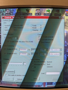

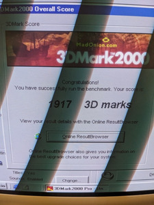

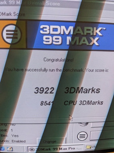

I have similar setup, same p5A 1.03, Voodoo 3 3000, Awe Gold, 3com nic, 128MB 100mhz and k6-2+ 570 @600 (5x100).
My score is 3922 in 3DMark 99 and 1917 in 3DMArk 2000. After install 3com nic drivers, 3638 and 1788¿?¿?
What values ​​do you get?

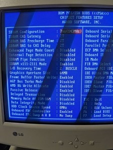

What values ​​do you configure in Bios, CTU and AGP tools?
    74.05 KiB
    273 views
