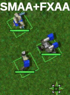

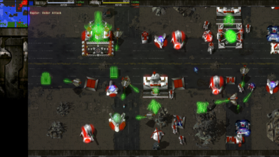

Recently i bought the ta commander pack and i decided to USE dgvoodoo2 to make it work
39.21 KiB
2314 views

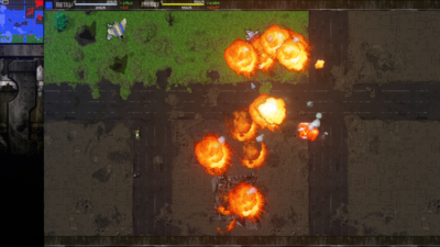

Since the game is a bit old ,I decided to use the last RESHADE
version to enable SMAA and FXAA and other cool effects.
66.1 KiB
2314 views

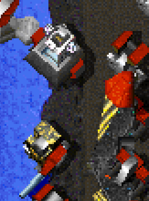

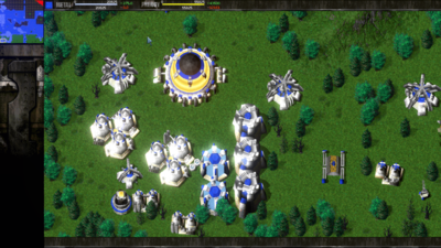

HERE IS A BETTER INSIGH IN CASE IN CASE YOU're ARE NOT CONVINCED
75.56 KiB
2316 views
34.68 KiB
2316 views
Total Annihilation uses its own internal software renderer, Beats me how some generic DirectX/OpenGL hack could improve the rendering here... The second image just looks more blurry to me.

Reply 4 of 18, by appiah4
Not sure what you mean by 'works' but what I see in the second screenshot is neither texture filtering or edge anti-aliasing, it's almost just a blur/smear of the framebuffer.. I can't in all honesty say whatever dg did here improves anything.
Reply 5 of 18, by gerwin
@lambdatorus.
Well. I get what you say, but my case still stands. The 3D rendering of Total Annihilation is done with its own internal software rendering. Not with Direct3D or OpenGL. Thus Direct3D/OpenGL settings or hacks do not apply to this game. The presence of DirectDraw does not change that, since DirectDraw is just for handling 2D graphics.
Software 3D rendering = Internal code in the game executable. Different for each game. Does not use 3D hardware or drivers functions. Details remain unknown until reverse engineering of the game is done. Can only be improved by changing the game executable (aside from maybe some 2D scaling algorithms which apply to the screen output as a whole, just like a photoshop filter).
Direct3D rendering = External Windows API. Universal and documented. Uses 3D hardware and drivers functions. Uses API interface calls that can be 'Hooked'.
Reply 6 of 18, by lambdatorus
Hi appiah4 and thanks for replying ,

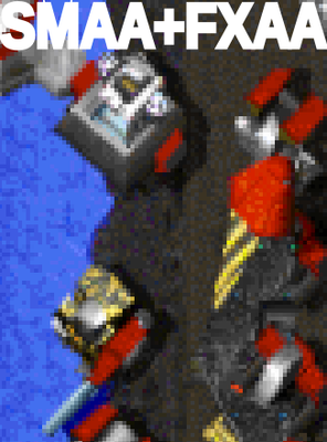

To improve my total annihilation experience, I use dgvoodoo + reshade.That mean thanks to dg's works ,(and no my "works"-> that is dg's "works" 😀 ) ,I can use a software called reshade.
Then when i start total annihilation, I can access to a menu that let the user activate cool effects. Like FXAA and SMAA .Because you said this , I DOUBLE checked 😀 in game that the effect is relevant.
So ,i opened the reshade menu and turn the SMAA and FXAA ON and OFF.And i can honestly testify that it improve ARTISTICALLY 😀 the game appearance.+ I added an ambient light effect and it look OK. 😀
39.21 KiB
2314 views
66.1 KiB
2314 views
BUT I understand you don't see the difference with two Images.No problem for me. BUT ARTISTICALLY speaking ,Having played a WHOLE GAME SESSION, the game looks BETTER .
So Honestly , you get used with the effects and it doesn't disturb during GAMEPLAY.And that the 😀 IMPORTANT POINT. 😎
BECAUSE IN TA , there is no texture filter and AA .And that is very important since the robot are sharp-edged.And the green selectionboxes are sharp BUT when you enable SMAA all sharp edges are soft. I repeat ,I checked myself to be sure. SO maybe you right in a programming PERSPECTIVE, BUT not in a visual PERSPECTIVE. SO here It's about checking if looks OK INGAME and it is.It's not about programming here.
SO the important here is what you feel INGAME and the sharp edges are soft.Still the UI is a little affected BUT ,I played a whole game AND it doesn't disturb during GAMEPLAY at all:happy: .
and Thanks again for replying appiah4 .

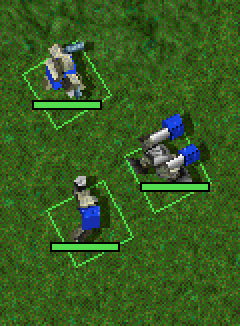

Hi gerwin,
SO maybe you're right in a programming PERSPECTIVE, BUT not in a visual PERSPECTIVE.
34.68 KiB
2314 views
SO here It's about checking if looks OK INGAME and it is.It's not about programming here. 😀 BUT thanks anyway for the course doc!! I will remember that 😀
have i nice day gerwin and thanks again for the detail 😀

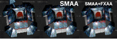

Reply 8 of 18, by gerwin
I see a difference, but I don't know what to call it but 'Blurring' of the entire screen. So if you like it that way that is fine, and you did put in a good effort to show what you are seeing, but it is false to call this actual SMAA or FXAA of the game's 3D polygons.
1) because it does not look like that.
2) because it is technically impossible.
http://mavorsrants.blogspot.com/2012/04/total … ics-engine.html
The engine is 256 color. It says that these units are sometimes drawn as pre-rendered 2D sprites to conserve speed.

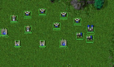

Reply 9 of 18, by lambdatorus
HERE ANOTHER PICTURES SHOWING DGVOODOO +RESHADE EFFECT:
23.9 KiB
2303 views
32.37 KiB
2303 views
AND HERE ONE MORE:
22.81 KiB
2303 views
35.04 KiB
2303 views
AND THAT'S IT.

Reply 10 of 18, by appiah4
That is not FXAA or SMAA, that is basically a blur shader across the whole framebuffer from what I can tell. The blur is helping you get around the sharpness issues with the edges, so that is the illusion of antialiasing there, but it's also blurring everything else as well and making you lose detail. If you like it better this way, go for it. I can't say it is an improvement, though.

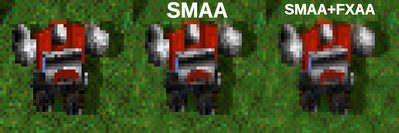

Reply 11 of 18, by lambdatorus
Hi appiah4 😎 ,
OK I got what you are saying. 😀 OK. YES the SMAA effect algoritm is set on edge color detection .And not edge depth detection.SO 😀 i agree with you 😀 when you talk about the framebuffer. SO this SMAA effect ,is ,and i agree with you ,set to work with the framebuffer.
BUT the algoritm of this SMAA effect 😀 STILL have edge detection 😀 , BUT like you said , 😀 through the framebuffer 😀 . So it analyse the framebuffer , and according to its parameter , detect edges that is in the framebuffer before processing,:happy: .SO technicaly, i agree with you partially.
BUT VISUALY SPEAKING,this effect is good looking. 😀 .And it's NOT ,and i don't agree with that, a simple BLURRING.Because a simple BLUR just PROCESS every pixel of the framebuffer.THIS SMAA effect is set to blur the edge inside the framebuffer.And I got good results with this.And it almost do not affect the 2D assets.
FINALLY,you are not considering total annihiliation asset which are very noisy.So i tested the FXAA effect and set it for removing the noise that is omnipresent in this game. And I got a good result. The game look more polished in the battle,with on one side soften edges(through framebuffer) , and on the other side with much less noise.+cool light effect. 😎
That is the main issue with this game.Just check the fullscreens i provided here (open the images on a new tab to see at full size):

Reply 12 of 18, by David_OSU
lambdatorus wrote:
I agree with you, lambdatorus, the SMAA/FXAA processed images look better to me also. There's a bit of personal taste here, some like their pixels all sharp and pixelly, and some prefer a softer more natural image. You are correct in that SMAA and FXAA are both screen space anti-aliasing filters and work with any aliased image, whether it was rendered by a software renderer or D3D or OpenGL. The technique used by FXAA, in particular, is to detect and remove aliasing from ANY image.
Given the source material shown in your screenshots, I would suggest trying out an xBRz filter with Reshade. If this was a DOS game running under DOSbox, I would probably do 2xSAI scaling in DOSbox followed by an xBRz pixel shader. The 2xSAI will aggressively remove all the single pixel texture noise and aliasing and the xBRz scaler will then expand the image resolution without additional blur.

Reply 14 of 18, by appiah4
The issue here is that FXAA and SMAA algorithms detect aliasing based on geometry and color changes compared with neighbors. TA's noisy assets seem to be throwing the algorithm off here. Just look at the ground texture, the AA filter is turning it into a blurry mess. Yes, it obviously helps with edges but it also completely destroys texture quality. That is my stance on this..
Reply 15 of 18, by David_OSU
gerwin wrote:
Haven't found a similar simple statement on SMAA yet...
There's more than one type of SMAA filter implementation (here's a good reference: http://www.iryoku.com/smaa/downloads/SMAA-Enh … ntialiasing.pdf). When SMAA is implemented as a post-processing filter that can be used by Reshade, it only has access to the final rendered image, and is strictly a screen-space antialiasing filter (comparible to FXAA). Other implementations can be applied earlier in the rendering pipeline, but these, of course, can't be applied to a software renderer without modifying the original source code (and would be implemented by the CPU rather than a GPU shader).
It doesn't make sense to me to apply BOTH SMAA and FXAA post-processing filters, because the filtering applied by the first filter will prevent the second filter from detecting any jaggies to process. Just use one or the other, whichever looks best on this particular game.

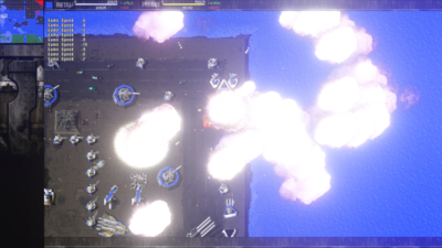

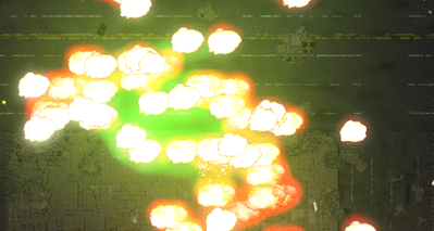

Reply 16 of 18, by lambdatorus
Today, i recently tried to add bloom effects to Total annihilation .It took me hours struggling with config file and game asset,but i did something good already. 😀
***************************UPDATED BLOOM EFFECT***************************
Recommended look this pic at fullscreen 😎
1.25 MiB
2189 views
I set the effect so it touch mostly weapon effect / green lathe / explosion.
