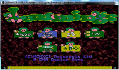

Well, I encountered this bug recently. In Lemmings and Oh No! More Lemmings (using the CD version BTW) when you finish a level, you have the option to continue to the next level or to return to the title screen. If I choose to be taken to the title screen, I go to it, and then the game hangs.
If I choose to continue to the next level, it still takes me back to the title screen to then hang! Newer versions are supposed to solve problems, not originate new ones! Because I then tried with the 0.74-2 release and that doesn't happen. Can it get fixed? Thanks beforehand!

Reply 5 of 11, by olddos25
Update: I recently discovered that when I press the right mouse button with the title screen locked up, it unfreezes for some reason. And then I can continue to the next level like normal. That's neat, but a little strange...

Reply 9 of 11, by Yesterplay80
I just downloaded the game (for testing purposes only!) but couldn't confirm your problem, even with the SDL.dll coming with ECE. Would you please post your .conf file, maybe it has another reason? Do you run DOSBox under Windows or Linux?
Btw.: What makes you think the game has frozen? Because you can't see a mouse arrow? Are the Lemmings at the bottom moving? Can you choose the options with the F-keys?

Reply 11 of 11, by olddos25
Qbix, if I use the SDL from DOSBox 0.74-2 on SVN, it lets me continue. Like, it doesn't go to the title screen to then "freeze" but it goes to the summary screen of the next level.
Yesterplay, it looks more or less like this:
118.48 KiB
1911 views
The Lemmings at the bottom of the screen don't move, there normally isn't an arrow on the screen, so I can't see it, and I can't trigger things with the function keys. So yeah, it is frozen.
