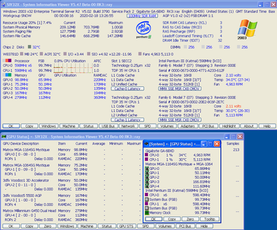

Reply 36 of 44, by red-ray
Baoran wrote on 2020-02-17, 10:39:
I have a gigabyte GA-6BXD with dual P3 450Mhz attached to it, but I have no idea what I would use such thing for personally. Would there be some retro use that a Windows NT 4.0 would be best suited for?
Twenty years ago I used to run NT4 on my GA-6BXD, I still have the system and have all of W98SE + NT4 + W2K + WXP + 2003 installed and of these 2003 works the best. I use it mainly for testing the SIV GPU support as it can handle several GPUs.
file.php?id=77205
    67.68 KiB
    724 views
