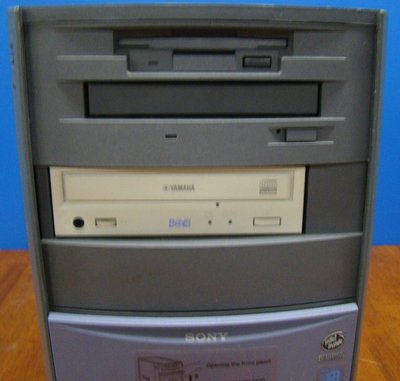

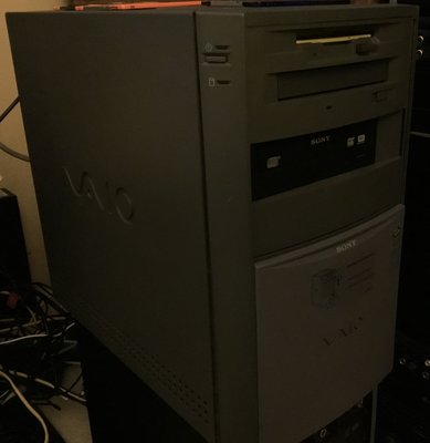

I plan on restoring this Sony Vaio desktop to original with some upgrades.
It has a Pentium MMX 200mhz CPU with 128mb ram.
And will be running DOS / Win95c
Questions:
What Video cards should I use to keep it original ?
What sound card should I use ?
Should I add a Yamaha XG sound card ? Or other Yamaha sound card ? I also have an Audician 32.
I want to keep this computer all Japanese components I can.
It has ISA and PCI slots available.

Reply 1 of 24, by spiroyster
Are you sure thats got 128MB RAM? The auction for the pictures you posted say 32MB? Looks pretty original to me.
That was the first VAIO. Video is onboard so if you want to keep it original, keep a graphics card away from it, but the second VAIO desktop (PCV-T700MR) had a ATi Rage II if you did want to put one in.
https://www.sony.net/SonyInfo/News/Press_Arch … -056/index.html
Sony made some gorgeous desktops, way ahead of their time in terms of design.

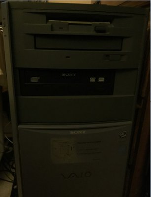

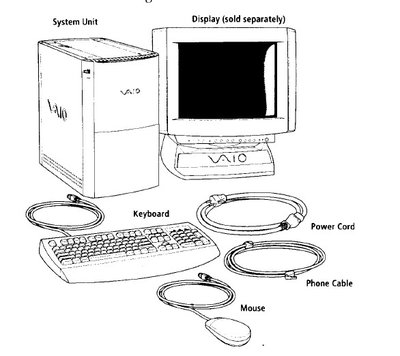

I am trying to restore a Sony Vaio PCV-90 desktop.
It has a Pentium 200mhz CPU and 32mb ram.
I have Win95c installed.
Audio Yamaha YMF-701s is working fine with Yamaha Audician-32 drivers.
I need to get USB working.
I need USB update driver package for Win95c.
Windows 95c device manager shows that I need "PCI USB driver" ?
And is there a PCI USB adapter with Win95 support ?
And I need a good network adapter 10/100. Does anyone know of a good one that works vanilla with Win95c.
I have 4 PCI slots and 3 ISA slots.

Reply 8 of 24, by andrea
Have you installed the USB supplement and the supplement to the USB supplement? They should be in OTHER\UPDATES\USB on the Windows 95 C CD. If yours doesn't have them, look on the net for "USBSUPP.EXE" and "USBUPD2.EXE".
You can also try XUSBSUPP. I've never personally used it, but I have heard good things.
Only for 1.1 cards. The thing is that 95's USB support is surprising that it actually works at all, the less you mess with it the better, if you can get the onboard to work I'd stay with that.
What kind of motherboard does the thing have?
If you get a 3com 3C905B or a Intel PRO/100 you can't go wrong. Also RTL8139s can work, but those are rubbish aren't that great, especially on slow machines.

Reply 10 of 24, by Intel486dx33
Thanks for your comments people. I will try them.
Update:
Thanks those USB updates worked. I have USB working on my Win95c computer now.
Works good for USB 1.1
Using a Patriot USB 2.0 flash drive.

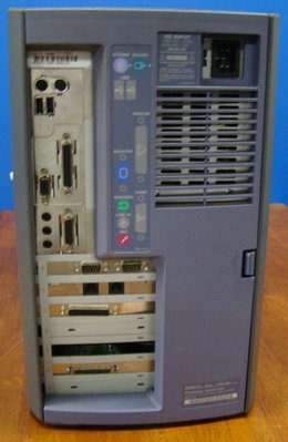

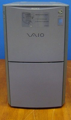

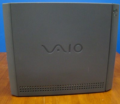

Here is a Sony Vaio PCV-90. This is one of the early Sony Vaio Desktops.
It has 4 ISA slots and 3 PCI slots.
Supports up to 128mb ram.
200MHz Intel Pentium MMX, 2.5 GB Hard-drive loaded with Windows 95, Onboard ATI RAGE 3D Graphics Acceleration 2 MB EDO
Onboard Yamaha audio via YMF-7xx driver.
Sold for $2500 in 2007.
I like this computer because it is basic and has ISA slots and NO TV capture stuff like the NEWER Vaio's do.
What I don't like is the Cheap Sony Vaio purple skin they put on this case.
It is cheap and comes apart easy.
I upgraded the ram to 64mb and added a DVD drive because I had one lying around.
It can't play DVD movies but at least I can read DVD data disks.

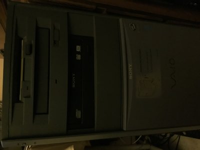

Reply 16 of 24, by sonypcv90
So I was throwing out a bunch of old electronics this afternoon and remembered that I had a PCV-90 under my bed. I don't think I was quite a teenager at the time, but I remember the Sony virtual environment for launching applications being amazing. As was 3D Movie Maker. I also thought it would be cool to get it working. That is when I stumbled upon this thread. I'm wondering d0ugb, were you ever able to make an ISO of the restore disks? That would be so awesome. Thanks.
