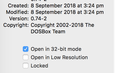

Two bugs. Bug #1 present in both 0.74 and 0.74-2. Bug #2 only present in 0.74-2.
Host platform:
MacOS 10.13.6
Macbook Pro Retina i7 with discrete AMD graphics (with GFX switching to Intel Iris Pro)
16GB RAM
Built-in soundcard
Bug #1 :
Affected versions: At least 0.74 and 0.74-2
Problem: Fasttracker II runs too slowly and breaks up, depending on what page is being displayed in Fasttracker II.
Solution: Change output=surface to output=opengl
Other DOS programs affected?: Untested.
Bug #2 :
Affected versions: 0.74-2 only. 0.74 is not affected.
Problem: Fasttracker II is missing channels and plays back corrupted noises on some channels when in GUS mode. Soundblaster mode is not affected.
Solution: No solution found. Swapping IRQ lines 5/7 between GUS and Soundblaster does not help.
Fasttracker II configuration:
MOD file for testing: ambpower.mod (Ambient Power by Vogue of Triton, 8 channels Protracker)
Output device: GUS or SB
Sampler: GUS
Mixing frequency in FTII: 44100, interpolation off, 8 bit mixing, Amiga frequency table
GUS addresses: $240, DMA 3, IRQ 7 (also tested with 5), RecDMA 3
SB addresses: $220, DMA 1, HDMA 5, IRQ 5 (also tested with 7), MIDI port $330
GUS DOS driver disk is installed.
DOSBox configuration:
Audio mixing rate for all sound devices: 49716
Other rates untested. To confirm: is this where the regression is?

UPDATE:
Selecting this in "Get Info" fixes the problem - confirming the issue is definitely due to faulty 64 bit compatibility:
50.9 KiB
2149 views
Screenshot
But this is surely going away soon, so at best a temporary fix.

Reply 6 of 19, by Dominus
Rank DOSBox Moderator
DOSBox Moderator
as OS X 10.14 did away with the "Open in 32-bit mode" it definitely is something that needs fixing.

Reply 16 of 19, by Dominus
DOSBox Moderator
So I forgot to write, thanks @digistorm for reminding me.
I thought I could circumvent this with info.plist magic, but there is no way you can do this 🙁
There are two other ways:
- Right click the app, hold down the control key and click on open -> starts in 32bit mode 😀
- use lipo in terminal to delete the 64bit arch from the dosbox binary permanently. http://osxdaily.com/2006/11/22/ten-os-x-comma … not-know-about/
