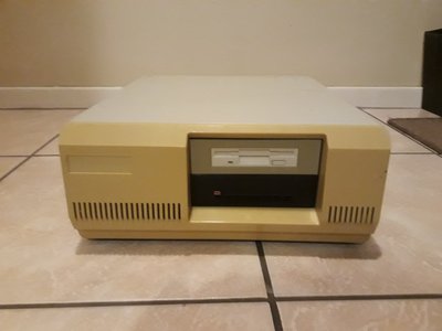

I recently came into possession of this pictured ICL PC with an Intel 386DX 25 MHz CPU and 8 MB of RAM.

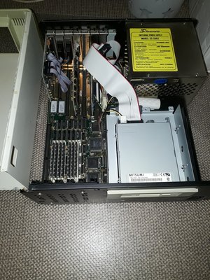

It has this motherboard inside the case: http://arvutimuuseum.ee/th99/m/U-Z/30499.htm
It also has the Intel 80387DX 25 MHz math co-processor, some unknown 8-bit Async serial card, a Realtek RTG3105E 256KB 16-bit ISA graphics card and a Western Digital 85 MB hard drive (which still boots up).

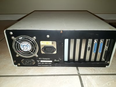

The case is a bit impractical for me, since it doesn't have any turbo switches in the front and the PSU is one of those types with the switch on the side.
I do have other 386 systems (a 386SX-25, as well as two 386SX-33's and two AMD 386DX-40's).
I was wondering whether there is any particular reason or "value" to hang onto this 386DX-25. I'll probably just hang onto some of the memory and the hard drive but, thinking of letting the rest go.

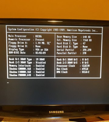

The CMOS setup also seems to be one of the older revisions.

Front

Rear

Inside

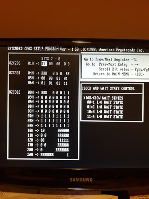

CMOS Setup

CMOS Setup 2

I see there is no cache in this machine so it's kinda meh... I had a Hyundai 386DX25 that was cache-less as well, didn't find much value to it tbh , a normal DX40+128kb is a much better option.

Damn, this is an outstanding machine!
Real connoissoirs appreciate this:
- C&T chipset (by far the best one at that time)
- Full AMI bios setup. You can even fiddle with the chipset registers.
- 5150 class heavy high quality case.
- who knows about computer history knows ICL, their quality and their importance
For this box I would ditch a dozen of these mass produced late 386/40 poor quality nonames with cloned CPUs and crappy chipsets like UMC, SIS etc.
P.S. Turbo switches are pointless on all computers except PC/XT clones. They are just a marketing gag which tricks people to think "turbo=faster", which is nonsense.
The purpose of these switches was and is to make the machine compatible with 4.77 MHz 8088, for allowing early PC games which used loops instead of timers to run at correct speed. Obviously, this only can work at 8088; even on an 8086 that won't result in "correct" speed. For this reason, I observed the turbo button never being released on all computers past 8088.

You should check out the speed of your DRAM, maybe there's no cache because it DOESN'T NEED cache.
Try to put the best ram you have (70-60ns sticks) and lower all the timings the lowest the bios allows you and then run some benchmark on it

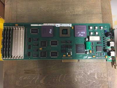

Hi Dicky96,
I checked on Vogons and read that you had worked for iCL. I have this beautiful i386 SBC from iCL which I would like to bring to life using a PICMG backplane. I have some issues with it and was wondering if I could contact you directly to explain the problem I have. On the passive backplane I've installed a controller for hard- and floppy drive as well as a graphics card and an Adlib sound card. As a harddrive I use a industrial grade compact flash card of 256MB. The systems boots OK. I get to boot from a disk and manage to install DOS 5.0 on it. However, on the next boot I get the following message: BIOS(14): Backplane ID incorrect. I removed the battery and believed to have cleared the BIOS settings. The problem remains. Are there some hidden BIOS settings for backplanes on which the SBC is mounted? I don't really understand what provokes this error message. Looking forward to your feedback. Sorry for using this post for my problem. I didn't know how else to send you this message.
    1.63 MiB
    255 views
