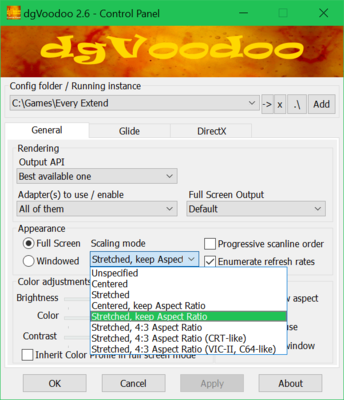

Reply 3 of 32, by ZellSF
eierfrucht wrote:
If you set dgVoodoo2 to use any of the scaling modes below the first three,
I may sound stupid, but what do you mean by 'below the first three'?
First three in this dropdown:

Reply 4 of 32, by Dege
Yes, as Zell says, dgVoodoo has its own scaling mechanism for 'Stretched, *' and 'Centered, keep Aspect Ratio' scaling modes. This is plain bilinear but you can force point sampled in the config.
'Unspecified', 'Centered' and 'Stretched' are up to the driver/display (the 3 first options from the dropdown list).
So, basically you'd like new scaling filters beyond the bilinear/point sampled ones?

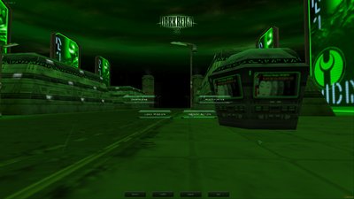

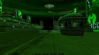

Reply 17 of 32, by ZellSF
Also more on scaling, but the other way. I thought downscaling worked properly in dgVoodoo, but I guess not? Unless I'm doing something wrong but I can't think of what that would be.
Here's dgVoodoo scaling from 3840x2160 to 1920x1080:
228.12 KiB
2772 views
Here's how most scalers would scale from 3840x2160 to 1920x1080 (this case it's Irfanview's downscaling, but all the other methods I tried gives similar results):
220.2 KiB
2772 views
What's going wrong here? There's obviously a lot of aliasing in dgVoodoo's downscaling, plus the font problems.
Have anyone successfully used dgVoodoo for SSAA?

Reply 19 of 32, by ZellSF
Dege wrote:
ZellSF wrote:
Also more on scaling, but the other way. I thought downscaling worked properly in dgVoodoo, but I guess not? Unless I'm doing something wrong but I can't think of what that would be.Here's dgVoodoo scaling from 3840x2160 to 1920x1080:
Is 3840x2160 a DSR? I tried it in the traditional way (forcing 2x resolution of my native one then let it get downscaled but it worked as expected).
I'm using the "Stretched, keep Aspect Ratio" option, where dgVoodoo's downscaling shouldn't be aware of, or care about what sort of resolution 3840x2160 is. Desktop resolution is set to 1920x1080.
I'm playing Dark Reign 2 with its native resolution set to 1920x1080 and dgVoodoo's resolution setting set to "2x" (which would be 3840x2160).

Edit 2: dgVoodoo with 3x resolution force:
492.48 KiB
2713 views
dgVoodoo with 4x resolution force:
447.92 KiB
2713 views
3x resolution force looks correct while 2x and 4x are all sorts of wrong.
I've also turned off DSR and made sure that none of the 2x/3x/4x resolutions are supported by my GPU drivers; dgVoodoo is handling the downscaling.
