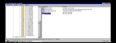

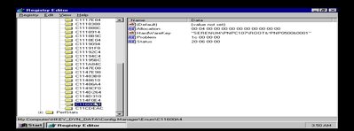

The value it's generating with PNPC107 is:
0x0000007c8230f530 "(\x1$PNPC107\\00000001\\MODEM,PNPC107\\ModemDC)"
Would that be a correct ID for PNPC107(Generic modem)?
This is what I can find in the registry with the PnP modem and what looks like the actual modem for said port that was manually added:
133.82 KiB
875 views
What seems to be the modem that's installed correctly.
136.94 KiB
875 views
What seems to be the PnP detected device.
Edit: So that error code (1c) means that the device drivers aren't installed?
