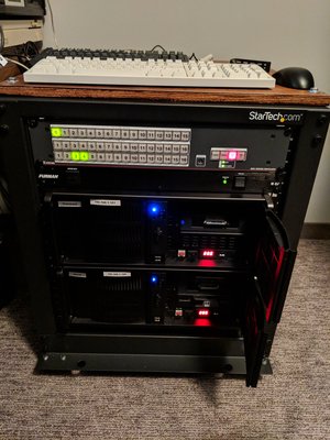

Working on a two-PC rack designed for hot co-op action. Going to start posting images and updates here. There's a lot of games and a lot of years to cover. A friend and I will be putting these through their paces soon enough. In addition to the two PCs, I'll be receiving an Extron switcher that does both VGA and DVI that will also live in the rack to simplify cabling.

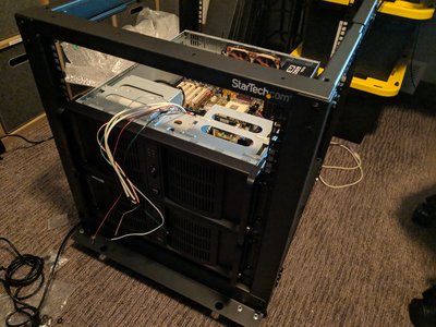

2019-02-16: Building the second PC in the rack (the first one is below)

Reply 1 of 14, by SaxxonPike
I've named PC 1, "Appia".
I've named PC 2, "Ironwood".
They're named after towns in Legend of Blacksilver for the Commodore 64. 😀
Ironwood was rock solid, I got co-op over IPX working for both Doom and Duke 3D. I had a problem on Appia that was related to power saving options - the GeForce driver crashed when coming back from screen-off. I disabled all those settings on both machines, rock solid multiplayer now.

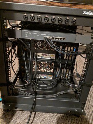

Added a Raspberry Pi to the network, so it will act as a file share I can map a drive letter to. I map the same letter on both machines so that even the config files are the same.
378.7 KiB
1654 views
Full rack is looking good. I found an Extron SMX with VGA, DVI and 5-pin audio modules installed for cheap. The DVI module is even the Pro version with HDCP support. Not that I'll really ever be using that feature, but it's nice to have.

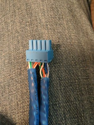

I wanted to use my Extron SMX's audio routing module, so I'm making a very amateur attempt at making an audio panel.
587.24 KiB
1512 views
Extron uses a 5-pin setup, and I decided to use some of the CAT6 cable we had sitting around:
1.07 MiB
1512 views

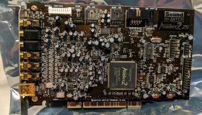

I'll be replacing the DS-XG cards with SB Audigy 2 ZS (non-OEM) cards:
231.69 KiB
1306 views

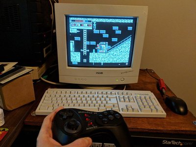

Also managed to bag a monitor that was about to be discarded from a local museum:
178.31 KiB

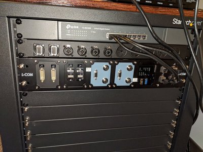

Reply 12 of 14, by SaxxonPike

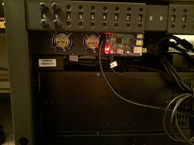

I've added more IO to the rear, so that I need to mess with the computer cables less. The cart does need to be moved for our events, after all.
