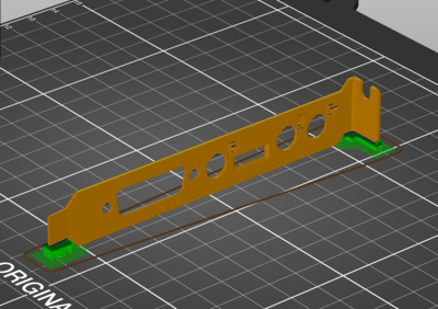

Reply 12 of 14, by Thermalwrong
Hey folks - here's the 3d printable model of my CT1600 bracket, it should also fit the CT1350, CT1330 and CT1740 I think 😀
Tested this in a couple of cases - the bit around the Joystick/MIDI port is recessed slightly because the port sticks out far enough on mine, to make it impossible to install the card in an ISA slot otherwise. It's 1.4mm thick mostly and the thin part is 0.9mm thick.
734 KiB
937 views
606.19 KiB
937 views
Printing it in the orientation shown, with supports on the build plate, at .2mm layer height seems to give me the best results. Going with a smaller layer height might give more detail to the line-in and speaker indicators, but my printer struggled with bridging the gaps (the blue bits) when I did that? So YMMV.
The screw hole at the top is an m3 type screw, but it should fit 6/32 UNC as well.
