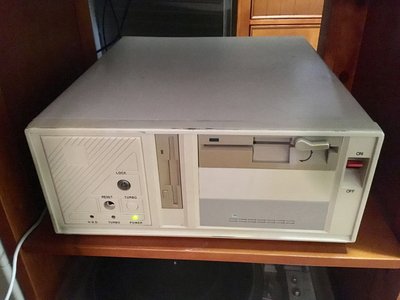

I finally have succumbed to my more basic instincts and acquired a 286 machine.
Here is a glamor shot of it just for kicks. I will post more detailed pictures later.

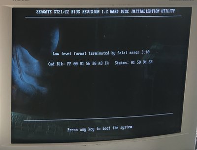

Here is the error code:
716.36 KiB
880 views
I have been able to solve the problem temporarily, however, by simply making a partition that is a little less than the percentage of the drive that FORMAT gets through before hanging (i.e. 37%, so I made the partition 35%.) This seems to work fine. I can format it and install DOS.

Reply 14 of 33, by retardware
Cool!
The error might be caused by wrong drive identification.
Say, data entered indicates a 800trk drive, and in case it is only a 300 trk drive, there will be a fatal error when trying to access track 301.
If this is the case, your "fix" by not using the part above, say, track 295 will work out fine.
