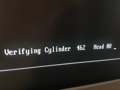

Reply 23 of 33, by keenmaster486
Update!
(retardware, I will try what you have suggested with SpeedStor. It would be great if I could get the original drive to work.)

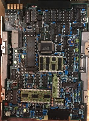

Reply 26 of 33, by retardware
Could you please post some photos of the drive?
For some reasons:
- To let us see a 1980s Toshiba 5" FH drive
- To let us see too which versions are built in and interpret the manual correctly together, with many eyes
- Nerd porn always is good 😀
Toshiba drives were no crude things like Seagate.
I suppose they had that "chip", actually a DIL resistor network in a socket like others too, but unlike with Seagate it was not intended to be removed for deactivating the termination, instead it was to be enabled by adding the respective jumpers.

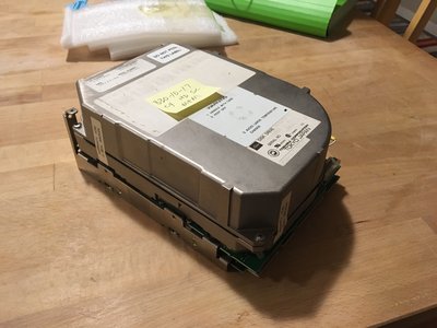

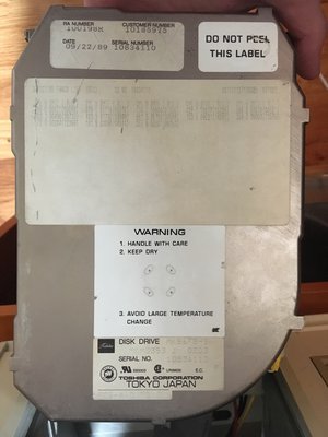

Reply 30 of 33, by keenmaster486
FINALLY getting around to working further on this 286.
Pics of the drive:
583.72 KiB
713 views
996.44 KiB
713 views
Right now the issue is that the controller is not even detecting it.

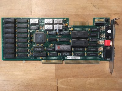

I also got a Tseng ET3000AX VGA card for it because the Oak sucks (will test soon):
852.96 KiB
713 views

Reply 31 of 33, by keenmaster486
Any tips on this hard drive? I cannot seem to get the controller to detect it. It says "controller reset failed - no drives installed" or something like that. The drive spins up, though. I have the jumpers set correctly as far as I know, but there may certainly be something wrong there.
World's foremost 486 enjoyer.
Reply 32 of 33, by keenmaster486
Finally got the huge drive working!!
I had to switch it to "radial" mode from "daisy chained" mode, whatever that's supposed to mean. After that, it worked perfectly. Low level formatted it using the controller card's utility, and dutifully entered the defect list printed on the label.

One more thing: I had to switch out the Tseng ET3000AX with the Oak card I had in it originally - the Tseng started having issues (monitor was detected as monochrome spontaneously and inexplicably!). Plus the Oak seems to actually be faster, and the weird color artifacts that were there before have ceased, probably because I have a different monitor now.

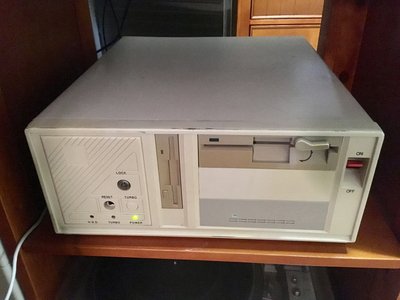

Reply 33 of 33, by keenmaster486
Some pictures! (also edited into original post)
