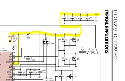

Reply 14 of 16, by Kizmo
And we have results. Most ceramic caps on graphics cards are just for power rail decoupling and their value or presence is not too critical.
But this area of the card is different. Right at the other side of the card we can see PWM regulator ic LTC1929. Regulators may have capacitors other than just plain old power rail decoupling such as timing capacitors. Their capacitance value is critical.
I did some measurements from my card and found that one end of C502 is connected to ground and other is end is connected to +12V input power through 10ohm resistor. And the junction between 10 ohm resistor and this capacitor is connected to LTC1929 pin 24.
Now lets have a look at application example of LTC1929 from its datasheet:
68.02 KiB
936 views
And what you know, 3DFX is following the typical application example. Kind of. I desoldered and measured the capacitor to be 1.5 µF and safe voltage rating would be 16V. X7R preferred.
This is special case of decoupling/noise filtering setup, actual value is not too critical, think anything from 0.47 to 10µF would work just fine. But it must be there.
