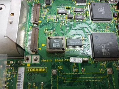

Reply 39 of 49, by TronadaSport
Is it possible to make a modification tutorial to place a cf card on the Toshiba T1800,1850? Step by step with all possible materials and details?
to be able to use it as a guide for the replacement of the original hard drive and bring these laptops back to life??
    1.61 MiB
    1291 views
    Bios T1850
