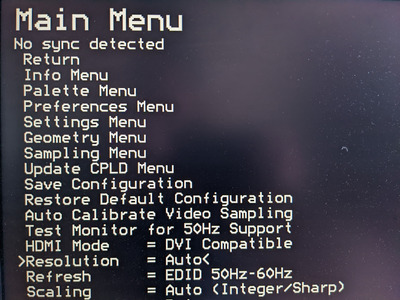

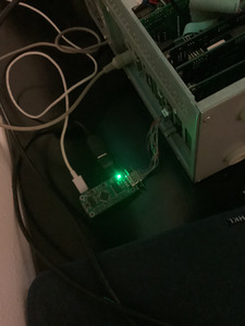

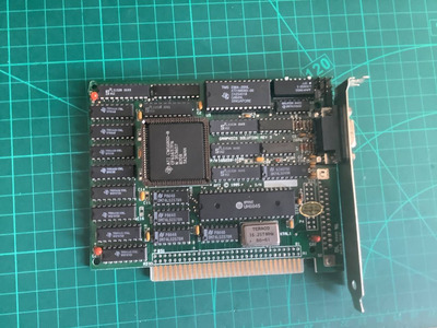

Reply 41 of 53, by matze79
Well.. i got the Picture issue fixed.
But my Picture is rolling vertical.
Any Ideas ?
The Card is a ATI CGA/HGC Card from a Commodore PC.

Reply 42 of 53, by weedeewee
matze79, what did you do to fix the picture ?
Do not ask Why !
Reply 43 of 53, by matze79
Made new Cable, and soldered new Xilinx
Somehow it always says no Sync.
Reply 44 of 53, by weedeewee
rolling screen would indicate some vsync issue.
Do not ask Why !

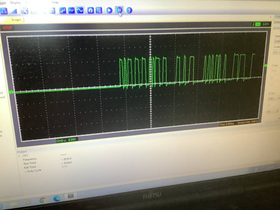

Reply 45 of 53, by matze79
Indeed, strange Output.
104.33 KiB
1359 views
141.7 KiB
1359 views
If i set the Card to HGC and hockup HGC Monitor the Picture is also rolling.
Composite is fine on TV Set.
Reply 46 of 53, by weedeewee
very odd indeed.
If i read the graph correctly, it would imply you're getting pulses of around 250~333 ns ( 4 - 3 MHz) on your vsync. That's way beyond spec for a simple HGC adapter/monitor 😏
Do not ask Why !
Reply 47 of 53, by matze79
Genoa EGA works fine 👍
Reply 48 of 53, by dmuntz

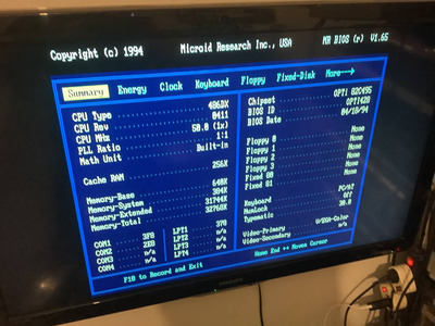

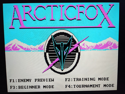

Reply 50 of 53, by Pierre32
I ordered one of these and it arrived today. What a fantastic device. I'm testing it with a CGA card for starters, but I have MDA and EGA cards to try too - which I've never been able to try because I don't have the CRTs. Out of the box, all I had to do was set the correct input profile (from the Acorn default to PC MDA/CGA) and I had perfect, crisp integer scaling on my Dell 2007FP. Just excellent.
