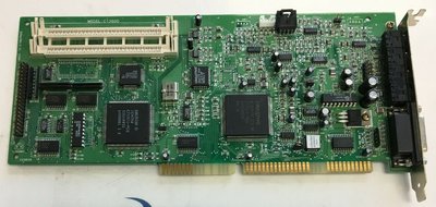

What is the best ram to use with this Sound Blaster AWE32 CT3600 sound card ?
EDO ?
FPM ?
60ns ?
2x8mb ?
2x16mb ?
The manual reads it supports 2 SIMMs and a total of 28mb. of memory ?

The CT3600 uses 30-pin simm memory modules.
There are no EDO 30-pin simm memory modules.
Depending on what you can find, either 2x 8 MB or 2x 16 MB but, you cannot mix them.
Also, if you install 2x 16 MB (i.e., 32 MB), then you will still only have access to 28 MB RAM (this is just how the EMU8000 synthesis chip works).

Creative specified 80ns
I doubt you would notice any difference between 80 and 60 and it would only matter when loading the soundfont so just go with what you can get

Reply 7 of 23, by dionb
Also, that's no AWE32 😮
Thats a CT3600 Sound Blaster 32 (non-AWE), which is in fact a Sound Blaster AWE64 without any onboard RAM but with the SIMM slots.

Nope, CT3600 as well:
Sound Blaster 32 Model Numbers
The following model numbers were assigned to the Sound Blaster 32:
CT36**: CT3600, CT3604, CT3605, CT3620, CT3640, CT3670, CT3671, CT3672, CT3681, CT3690
The comparable AWE32 was the CT3601.

The CT3600 has the EMU8000 chip. The CT3670 is the SB32 that has the AWE chip which is identical to the one on the AWE64 cards.
You can also flash the CT3670 with the AWE64 firmware if you want to disable the IDE port.

Actually, all "Advanced WaveEffects" cards (SB32, AWE32 and AWE64) has the EMU8000 synthesis chip on-board.
The CT3600 uses the CT2502 DSP chip which is a Vibra based chipset. I believe that this one does have Reverb, Chorus & Gain restored, wheras the earlier version (the CT2501, found on the CT3930), didn't have these functions available in the mixer utility
The C3670 utilises the CT8903 DSP chipset, which is the same chipset found on the AWE64.
