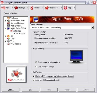

Reply 6 of 16, by SPBHM
kind of OT but I'm not finding the info and is related to drivers and this GPU,
when using DVI on a R100/RV100 card do you have access to scaling options like on newer cards? on windows 98 or xp
Reply 7 of 16, by swaaye
Radeons can't do aspect ratio scaling until the X1000 series cards. If that's what you're wondering. They all can do a full screen stretch though. It's called ratiometric expansion in laptop world.

Reply 9 of 16, by swaaye

R100 will not have "fixed aspect ratio scaling". X1000 cards are the first with that.
I get confused about DVI behavior daily ( 🤣 ), but I think the Radeon will output your selected resolution to your monitor, which the monitor can scale however it likes. However, if the monitor EDID doesn't enumerate a specific resolution, the Radeon will output the monitor's native resolution and stretch your chosen resolution into that as centered or full-screen-stretch. DVI is complicated and card/driver behavior varies.
The lack of aspect ratio scaling is especially annoying for notebooks. You get stuck with only stretched or centered output.
    88.76 KiB
    2717 views
    X800, for example.

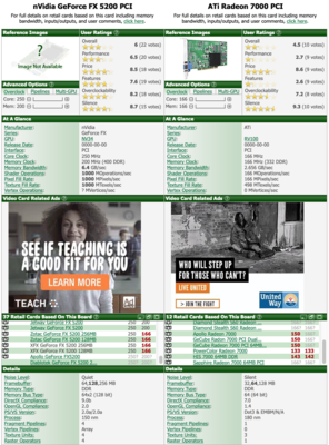

Reply 13 of 16, by dr.zeissler
The lights in DoomGL look better on 16Bit Voodoo1/2/3 then on 32Bit R7000.
How can I optimize it so that the coronas look better on R7000?
Interesting comparison though:
Reply 14 of 16, by matze79
Does mean nothing.
Just compare both cards on higher resolution and the radeon wins.
