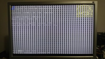

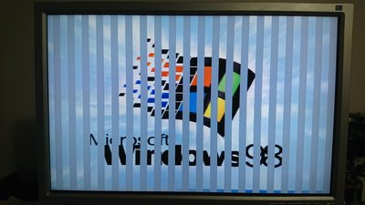

This time around i have another V5 5500 on the healing bench. The card belongs to a member of this forum.
Basic info:
- Non modified Rev 2500 V5 5500 AGP
- Suddenly stopped working, heavy artifacting during POST/boot and crashes in windows
- Judging from dust and fan motor wear the card has seen high number of hours

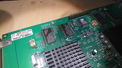

First step of troubleshoothing is cleaning. The card was dirty and nothing beats ultrasonic bath and alcohol. Then I checked voltages. Every rail was present and at correct level and there was no excessive noise or ripple which may indicate failing capacitors or vrm.
I kind of hoped this would be memory related issue and worked on that first. I resoldered and later replaced primary VSA-100 memory chips with known good ones but nothing changed.

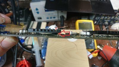

Then I noticed this
163.09 KiB
1710 views
The primary VSA-100 heatsink is literally floating on huge blob of adhesive. Someone at 3DFX did not do very good job of pushing the heatsink nice and flat on the chip when adhesive was still soft. This leads me to believe that the GPU itself is toast and needs to be replaced.
Luckily i have 25 brand new chips so i will give it a go tomorrow. This kind of failure is not entirely unheard of, i have replaced several failed VSA-100 chips, one V5 5500 needed both chips replaced before 3D was stable.

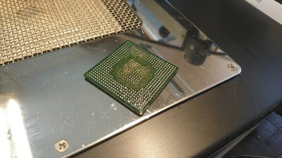

After heatsink removal i scraped off the thermal adhesive which was super thick.
221.99 KiB
1678 views

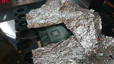

There was strange dirt like substance under the GPU. This makes me believe it may have caused the problem and maybe the chip is still good. But PCB can take only limited number of reflow cycles before risk of damaging the PCB is too high so i went for new GPU instead of reflowing or reballing the old chip.
318.48 KiB
1678 views

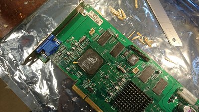

Here the card is cleaned, ever so slightly fluxed and being preheated to +140 C. Foil is protecting heat sensitive things like capacitors and fan connector-
189.96 KiB
1678 views

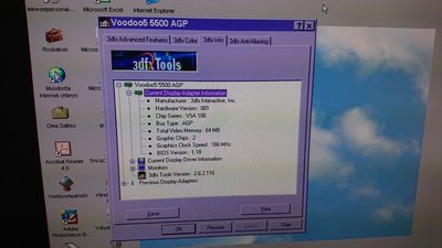

As alarm screams we hit the specified peak temperature of this soldering alloy (+210...+220C). Next step is nice and slow cooldown which results finer grain structure in joint which translates into more reliable soldering result.
Fingers crossed, will it POST without artifacts? Yes it did! And it booted to win98 and drivers loaded correctly.
210.11 KiB
1678 views
The card has been looping 3dmark99max for few hours right now, completly glitch and crash free! Another one saved!
