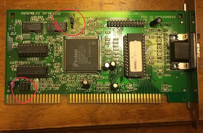

I have this STB trident 9000 ISA graphics card that won’t work.
When I power on the computer I get 4 quick beeps and no video.
I tried the card in all the ISA slots thinking it might be a resource conflict but
It would not work in any ISA slot. ( 6 total slots )
All I had connected was this one video card and the keyboard.
All my other ISA video cards worked fine.
Just this one gave me problems.
I do not have a manual fo this card.
There are some jumpers on this card but I do not know how to set them.
Anyone know how to setup these jumper correctly ?

If I were a betting man, and looking at my card.
I'd say Jumpers 2,3,4 switch between 16 and 8 bit mode, and J1 at the top might change the display mode between interlaced and non-interlaced for high resolutions.

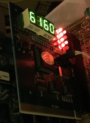

Okay, like I said I get 4 quick beeps on power on ( long, short, short, short beeps ).
Here is the error code from PC Diagnostic reader.
Reply 3 of 7, by root42
Going by this list:
http://www.elstonsystems.com/dl/manual_postcard_32.pdf
You are getting 61 as your error code (previous code: 60). This means, and I quote, depending on your BIOS:
  • AMI (61)Display memory verification over. About to go for DMA #1 base register test.
  • AST (61)RAM test.
  • Award (61)Try to turn on level 2 cache. Set the boot up speed according to setup setting.
    Last chance for chipset initialization. Last chance for power management
    initialization. Show the system configuration table.
  • Compaq (61)Enter protected mode.
  • Chips & Tech (61)Video
I would guess that you either have AMI or Award, since those are the most common BIOS's. If Award, it might be some problem with level 2 cache, it seems. If AMI it might still be a video problem, I guess? However the "Display memory verification over" hints at the VGA memory being ok...?

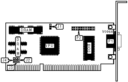

Also this should be your card: https://stason.org/TULARC/pc/graphics-cards/S … A-MACH-512.html

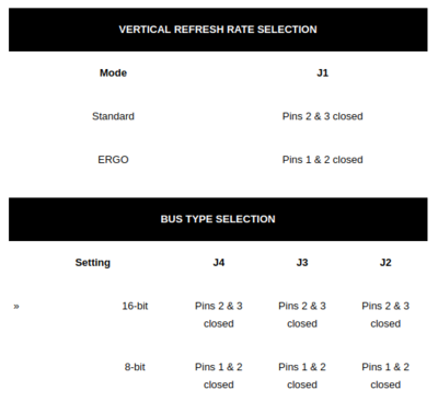

Reply 5 of 7, by Intel486dx33
Okay, I am going to label this video card “Not working / questionable ”.
I tried the correct settings but I get a conflict with my Gigabyte 486 motherboard.
All my other ISA video cards work fine with this motherboard.
Maybe it is just not compatible with this motherboard.
I will try in other motherboards.
Thanks for your help.
