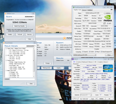

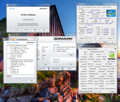

Since DX9/DX10 games programs can't use Tesselation, most GPUs can't be stressed "to max" on them.
Also, the sheer shader processing power of current (and even last gen GPUs) is WAY too much for any CPU under 5GHz clock to handle with old software such as 3DMark.
Side note : Best GPU utilisation you will see with 3DMark 03 😉

Of course getting ~99% across all tests is impossible.

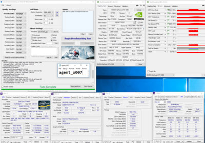

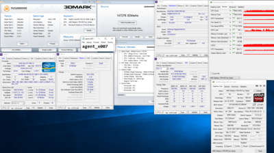

As for Crysis :
419.37 KiB
522 views
^GPU usage was never at 100%.
If you are asking for renderiung errors - it worked fine for me.

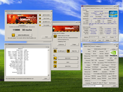

Yeah, these old benchmarks are a piece of cake for modern hardware. Even Ryzen's integrated graphics will run Crysis easily enough.
3DMark01 and 03 frame rates are downright ridiculous on modern hardware, often reaching into the thousands so long as you don't use Windows 10. 3DMark05 frame rates are much lower. Looking at GPU and CPU usage numbers during a 3D'05 run, it appears to be using just one CPU core. The GPU fan doesn't even ramp up.

Yep, it's completely CPU-limited. It only uses a single thread (on a 12-threaded processor, CPU usage is is only ~8% during the benchmark), and probably only uses SSE. After all, this benchmark does run on P3/Athlon XP.
