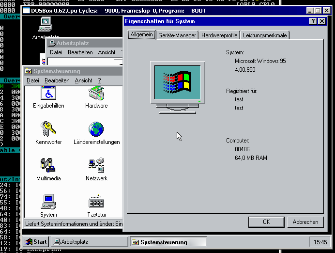

Well here's another screenshot (doesn't run out-of-the-0.62-box though).
soundblaster does not work in enhanced mode windows because
of paging issues, you can try to disable the virtual memory
(or how it is called)
@kekko: don't press any key during windows loading,
exceptions/illegal opcodes are normal (v86 and exception
handler setup)
dynamic core doesn't work
wd

Wow Windows 95.. Now that will be nice especially when trying to play Magic: The Gathering which will NOT run on Windows XP. Although, hopefully Manalink which is gonna be like an emulatorish thing for the orginial version including the addons looks promising. www.manalink.org is the main site which is a forum and everything is pretty much hush hush.
