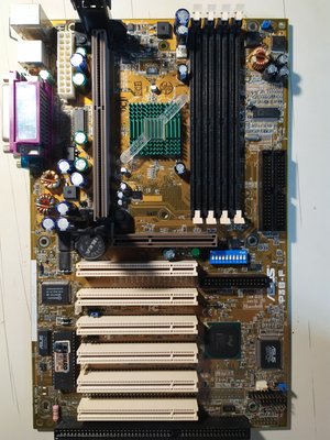

This is the first time for me to build a relatively old platform like this. Last month my friend built a 586 platform with a Pentium MMX 200, and I wanted to try something "older" than me, too. So I went to IdleFish (a Chinese second-hand website) and hoped to meet something old-fashioned with reasonable price. It was hard to find as old stuff like 486, 586 or Pentium II are usually of high price in China, which were, however, sold by someone who knew little about them although they got them from recycling center for almost free. 😠
I'm always a huge fan of something with more compatibility. After some research on Wikipedia I finally decided to get a 440BX board, which can be used with CPUs from Pentium II 266MHz to Pentium III 1.4GHz. It's awesome for a platform to be able to handle a huge range of frequency. Finally, I paid ¥202 (US $30) for an Asus P3B-F 1.04 and a Celeron 333.
1.25 MiB
2165 views

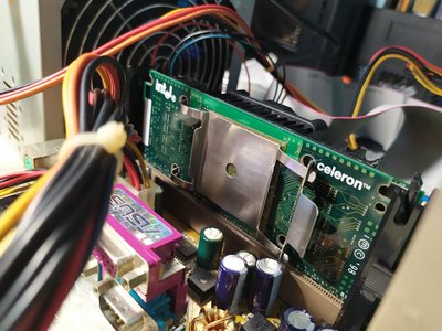

I spent several days and made huge effort to get it POST, that's another story. Maybe caused by a corrupt BIOS image, and after I flashed it with official latest beta BIOS, it worked flawlessly. Unfortunately, the Celeron 333 was burned due to my wrong installation (without retention bracket). 🙁
506 KiB
2166 views

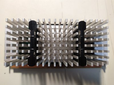

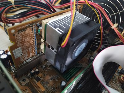

What wasn't bad is that I've ordered a Pentium II 450MHz for ¥60 (US $9). However, it came without a fan and there's no way to install a fan onto it. I'm wondering how can I get rid of the huge heatsink and install the smaller one from the Celeron?
693.56 KiB
2165 views
554.73 KiB
2165 views

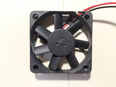

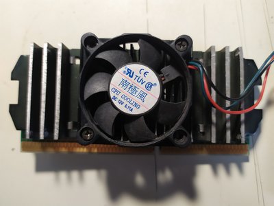

I had to use a 5cm fan and placed besides the heatsink... (¥23 (US $3.5) for two off-brand 5cm fans) But I don't have the appropriate screws to mount it!
453.56 KiB
2165 views
Therefore, I'm considering to replace the Pentium II 450 with a Pentium III 1.1GHz (100FSB/SL5QW) on a Slotket, but I don't know if there is a Slotket that supports both Coppermine and Tualatin CPUs?

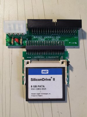

I bought a WD Silicon Drive II 8GB CF card for hard drive, as it uses SLC NAND and is stong enough to run Windows on it. And a CF to IDE (2.5), IDE (2.5) to IDE (3.5) adapter, ¥79 (US $12) in total.
778.52 KiB
2164 views

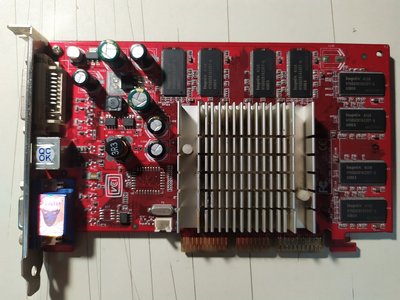

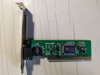

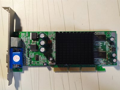

I got this GeForce4 MX 440 AGP8X card for ¥29 (US $4.3), a Realtek RTL8139D 100Mbps network adapter and a ISA soundcard with Crystal CX4235-XQ3 codec (PnP though) from my friend for free.
878.83 KiB
2164 views
911.28 KiB
2164 views
947.4 KiB
2164 views
I hated the Crystal driver. It was way too buggy! I have to disable it in device manager and re-enable it to get correct sound. I've ordered a FIC soundcard with ESS AudioDrive ES1868F, which according to other posts in vogons, worked fine under both DOS and Windows.

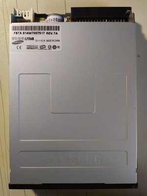

A nice, almost new floppy drive, Samsung SFD-321B. Worked smoothly and quietly. ¥50 (US $7.4) for two with cable. I'll install the other one into my Socket 754 build.

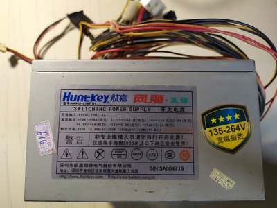

The PSU, Huntkey HK450-51APS1, which was made in 2015, is a 350W power supply unit. I got this from my friend for ¥15 (US $2.2). A small bonus, it comes with a 4-pin floppy power connector which was rarely found in other PSUs!
713.66 KiB
2163 views

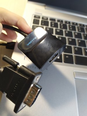

And the most strange thing maybe... A VGA to HDMI adapter, for my Dell U2415H monitor doesn't have a VGA port. It couldn't get 1920x1200 resolution, but 1920x1080 max. The video quality is mediocre.
475.19 KiB
2163 views

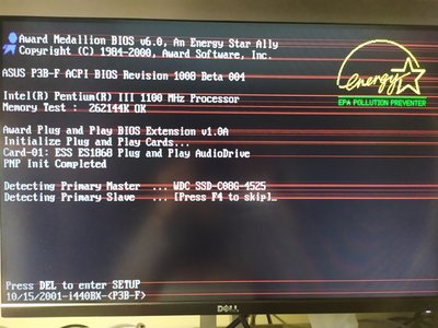

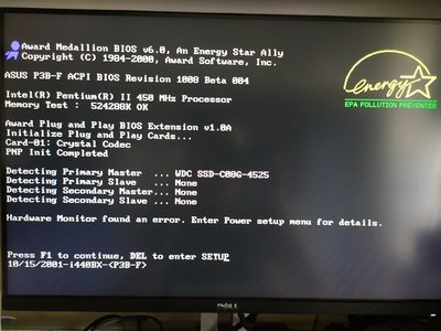

It's actually more exciting when I see the POST screen. The mobo itself was made in 2000, but in general the 440BX platform is even older than me! Maybe I'm too young to play around with these old stuff, but I'm happy to explore more and may want an older machine.
682.22 KiB
2162 views

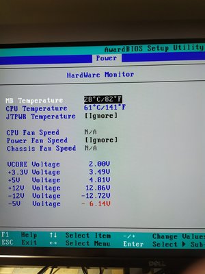

There was a -5V error, I wonder if this may cause any bad effect to my hardware?
EDIT: Thanks canthearu, this shouldn't be a problem.
960.3 KiB
2162 views

Reply 4 of 16, by canthearu
Your PSU doesn't actually supply -5V, so that voltage is floating, probably influenced by a -12V trace nearby.
Shouldn't affect anything with your hardware choices. Only a few ISA cards need -5V/.\\.

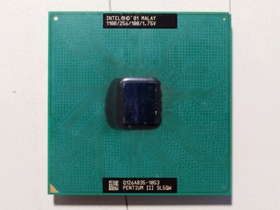

Reply 7 of 16, by th1r5bvn23
Got this Coppermine Pentium III 1100 (100FSB/SL5QW) from my friend for ¥12 (US $1.8, shipping only, and the CPU itself is free)!
569.86 KiB
2030 views

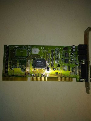

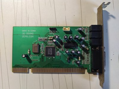

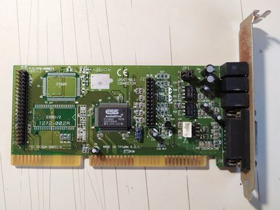

And, received this soundcard and had a quick test.
909.33 KiB
2030 views
I have some problems with it. When using WDM driver shipped with Windows 98 SE, the ESFM sounded not good. Missing notes, wrong notes... Then I downloaded a VXD driver version 4.04.00.1129, the ESFM sounded great but I noticed that the computer became really slow when trying to make sounds. That should be a driver bug.
I went to archive.org and hoped to find newer driver on the official website, however, ESS used a FTP server (which can't be archived by archive.org) to provide downloads and the FTP server is down. The latest driver for ES1868 is v1207 and the filename is 1868_v1207.zip. If someone happened to have that file please send it to me! Thanks a lot!
The noise of the card is bad. 🙁
EDIT: Thanks canthearu again, will test tomorrow.
Also I found the latest driver with google searching the file name, however actually I looked into that link before and thought nothing was there...

Reply 8 of 16, by canthearu
To reduce noise, change JP1 to pins 1-3 and 2-4. This will disable the onboard amp and provide much better sound quality (ESS1868 sounds pretty good, but the onboard amps are typically awful)
Reply 9 of 16, by th1r5bvn23
It did work but the sound was then too small to hear. I use a cheap Sony MDR-XB55 earphone. When enabled onboard amplifier, the sound was too loud and the noise was loud, too. But when disabled it the sound was small even turned the volume to max. I wonder if there's some way to increase the volume of line out with onboard amplifier disabled?
AMD K6-2+ 500, FIC PA-2013 2.0 (1MB cache), 128MB SDRAM PC100, Voodoo3 3000 AGP, Labway Yamaha YMF719B-S with NEC XR385
AMD Athlon 64 3000+, ECS K8M800-M3, 512MB DDR 400, GeForce FX 5200, SoundBlaster Live! SB0060
Reply 10 of 16, by canthearu
Yeah, that will happen if you disable the onboard amplifier.
You will need powered speakers, or an external amplifier for headphones.
Onboard amplifiers on ISA sound cards are almost universally terrible, it won't matter too much what card you use. Maybe a PAS16 would be better.
Reply 11 of 16, by chinny22
I actually prefer the large passive heat sinks, As your talking about front panel connectors I'm guessing you are using a modern case. As long as you have good airflow you don't need to worry.

Reply 12 of 16, by Tetrium
I also like the Slot 1 CPUs with larger passive heatsinks, if only because they are easy to cool with some added cooling.
Regarding the fan, you can try to strap it to the heatsink without using any screws (be sure to not bend anything or put too much stress onto something).
256MB should be enough ( 😜 )
And regarding the power connectors on your PSU, you can get adapters for the molex and the smaller power connectors, changing them both ways. I used them before and they work just fine.
Your PSU should be up to the task. Huntkey is not the best manufacturer though, but several of them have worked fine for a couple years for a couple rigs a friend of mine used (these were sA).

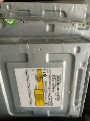

Get 3 brand new optical drives for ¥40 (US ~$6). Give away two of them to my friends. Samsung TS-H652H DVD±RW DL writer with IDE connection and audio out. It's nice to play CDs with it.

The Celeron 333 worked again! Noticeablely slower than Pentium II 450 but still nice to have it working. I just figured out that the retention mechanism of this board wasn't able to hold a Celeron properly. But I didn't manage to find a good one anywhere.

Look like you are missing two small flat black pieces that go in the corners. Back in the day I had a box full of them. Im sure you could 3d print something now, ur even use sugru.
Reply 16 of 16, by canthearu
You don't really need retention clips for the CPU on a slot 1 board, as long as you are not throwing the thing around, it will be fine.
The slot itself and the CPU card probably need their contacts cleaned. Use a pencil eraser on the CPU card contacts to clean them to a shine, and maybe some contact cleaner in the slot to help there as well.
