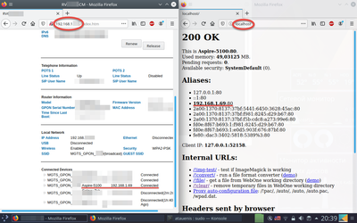

Reply 110 of 218, by James Gryphon
I thought I'd try this out to boost an old Mac (running OS 9.2)'s increasingly limited internet capabilities, but I've quickly discovered I have no clue about basic things. Instead of wasting time in vain, I thought I'd cut to the chase and just ask:
1a) How do I find my relevant IP or hostname or what have you in Ubuntu? (An IP seems like the most likely to succeed - a name like 'clementine' (the output of the 'hostname' command) doesn't seem like it'd cut it, and it didn't seem to do anything when I did try that, anyway. )
(Another thing that may complicate this - the networking scheme is in sort of a daisy chain; the gateway is accessed via an Android phone, which serves as a Wifi dongle via easytether-usb on my Ubuntu main machine, which is then connected to the G4 via ethernet cable.)
2) Does the WebOne CLI app provide any feedback at all when it has been accessed (after the 'listening for HTTP 1.x' message)? It seems difficult to tell otherwise whether you're actually successfully accessing the proxy, or else missing it somehow and using a normal connection.
Reply 111 of 218, by ATauenis
James Gryphon wrote on 2020-05-13, 15:33:
Try to see in network properties or run "ip addr" in Terminal. The hostname (e.g. 'clementine') is not that is need (it is working only between Windows Servers and Windows PCs).
Or it can be determined by accessing proxy status page on the proxy PC (the right window):
270.28 KiB
2229 views
The left is a page from my router, which telling same IP for the machine.
Don't forget to set DefaultHostName setting in webone.conf to the real IP of the machine. If it is dynamic, it should be edited on every start.

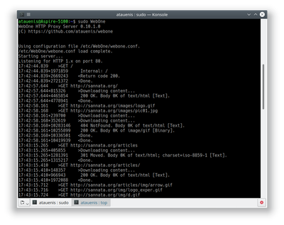

Yes.
