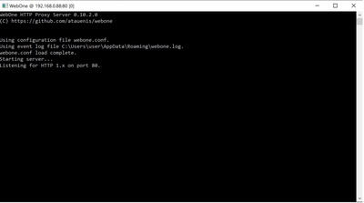

Reply 128 of 218, by Braca862
I am trying out WebOne for the first time on my Windows 10 laptop to test it on my Windows 98 machine . I have downloaded the 32-bit zip file as well as the 32-bit version of .NET Runtime 3.1.4. I added the IP of my w98 machine in the .conf file. Here's what I get so far, as shown in the attachment. This is normal, or do I need to add more stuff in the conf? (Note: I had to run WebOne as an administrator since just clicking it would get me the Access Denied error.)

Reply 129 of 218, by ATauenis
All is good. Set 192.168.0.88, port 80 as HTTP proxy server IP/port in Windows 98 browser settings. WebOne is ready for incoming requests.
If Win98PC will non recognize proxy (and there will be no messages in log window), disable Windows 10's Firewall (or open TCP port 80 in it).

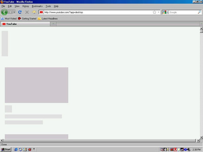

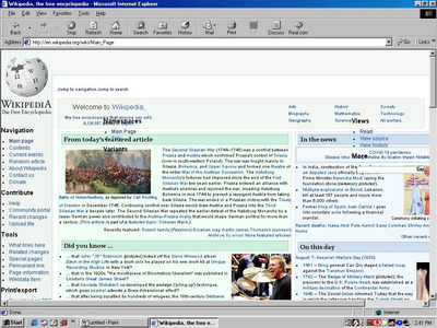

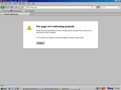

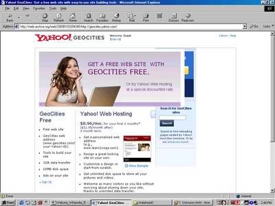

Reply 130 of 218, by Braca862
So here's what I have so far after using webone on my w98 machine, as shown in the attachments. Youtube doesn't seem to load correctly, and there are issues accessing Vogons using the proxy. I am still trying to familiarize myself with this proxy.
Anyone have any recommendations on how to make the best of webone?
An off topic question: Firefox does not appear in the taskbar when its open. This happens with every version I install. Any idea why?

Reply 131 of 218, by ATauenis
Braca862 wrote on 2020-08-07, 19:29:
Youtube doesn't seem to load correctly.
Try m.youtube.com. In June, it worked with Firefox 3.6 + "ViewTube with WebOne support". How it now, I don't know - have no time to discover.
Or, if there are any HTML+JS developers reading this topic, please help community, make replacements for YouTube scripts and/or styles for older browsers. 😀 WebOne can easily spoof any content of web pages on fly (like jQuery downgrade, included in default webone.conf).
Another task is that my fork of ViewTube user-script is now semi-obsolete, as it working only with Classic design (however, in June it worked after some dancing with a shaman tambourine which enabled the old design 😀 ). Need to apply all recent changes of source branch to my fork. But even the next update after fork time is requiring full rewrite of my patch, as sebaro rewrited Settings page from scratch then.
Currently I cannot find a few weeks of 24/7 time to made large edits. Less time (2-3 hours per week) is not enough, but it is all I have.
It may be due to two things:
1. Try to remove vogons.org from ForceHttps.
2. Try to remove:
[Edit:^http://vogons.org]
; fix for Vogons, a site that is working only at WWW.vogons.org
AddRedirect=http://www.vogons.org/%UrlNoDomain%
The first is not actually need, AFAIR. It was forgotten since debug time.
The second is to allow use IE 5.5 with Vogons (huh, in 2019 and with old design).
Probably these edits should help.
Also WebOne rely on Windows updates on server machine, so if the system have disabled updates, some sites may don't open. Especially this is related to Windows 7, however TLS is updating too frequently to guarantee any backward compatibility even for software, released yesterevening.
