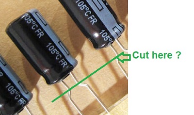

Reply 23 of 36, by user33331
The Panasonic FR capacitors arrived.
- They are rated +105 °C.
- How long can I keep hot soldering iron touching cap's leg without overheating ?
- With what temperature *C to solder and what Wattage ?
Is it useful to tape motherboard's tracks with lots of Chinese Kapton-tape or similar ?
- Hand probably shakes and tracks are like worst 1mm away from cap's leg.
Where to cut legs see photo ?

Reply 24 of 36, by canthearu
user33331 wrote:
The Panasonic FR capacitors arrived. - They are rated +105 °C. - How long can I keep hot soldering iron touching cap's leg with […]
You shouldn't worry too much about cooking the capacitor. It is possible, but difficult due to the capacitors large size and the fact that your motherboard will be taking a lot of heat away, it is quite difficult.
Depending on the wattage of your solder station, you will probably want to set a temperature of 300C or so. That would be ideal. However, unless your iron is very good and you have a good bit that transfers heat efficiently, you may need it a fair bit higher to work effectively on the thick multi-layer boards. I have to set mine to 400C on a 60W solder station, and I still wish I had more power for these things. I am strongly considering getting a better station that has the heater built into the tips, as i have heard these work better than traditional stations on difficult jobs.
Don't worry about the kapton tape, it is only something you would need if you are using hot air around components you don't want melted. Soldering irons typically don't need it. You won't be trashing any of the tracks near the solder points as they will be covered in thick solder mask that is largely unharmed by soldering.
I'll also be honest, I've never seen Panasonic FR capacitors come with legs pre-bent like that. they normally are straight. It makes me suspicious of the source of those capacitors. In any case, you can trim where you indicated to make it easier to insert into the board.

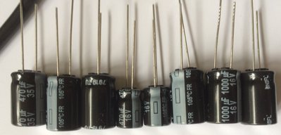

Reply 25 of 36, by user33331
Here is the seller: ( I'll send later more photos if counterfeit. )
EBAY= dmcomponents2011 ( D&M COMPONENTS ) UK England: Cheltenham, Gloucestershire.
https://www.ebay.com/usr/dmcomponents2011?_tr … =p2047675.l2559
"Panasonic low esr"
*1000uF 10V FR ( EEU-FR1A102L )
*1500uF 6.3V FR ( EEU-FR0J152L )
Thanks I must be sure that they are legitimate and not fake. I'll open paypal case if needed.
Can someone send a photo of genuine similar value FR caps ?
How to prove that they are fake other than weirdly bent legs ?

Reply 26 of 36, by BushLin
I would heavily assume those caps are fake, here's the datasheet
https://industrial.panasonic.com/cdbs/www-dat … BA0000C1022.pdf
Caps are purchased with specific leg widths in mind so they don't get changed without naming it differently.
Fakes appear commonly on Amazon too which is why I only buy from electronics specialists.

Reply 27 of 36, by BushLin
Here's a photo of three types of FR capacitors. Does the text size look wrong on what you received?
1.12 MiB
219 views
EDIT: It does look like some FR caps have legs like that

Reply 30 of 36, by PC Hoarder Patrol
Again, no expert (someone, please haul me up if I'm talking trash) but if I'm reading the Panasonic 2019 catalogue correctly these could still be genuine. Based on the OPs quoted part nos (which I assume came from the seller) these have formed rather than straight leads, with a 3.5mm spacing at the body splayed out to a final spacing of 5mm.
Reply 31 of 36, by ph4nt0m
Genuine Panasonic electrolytic caps have special T pressed vents. You can also see their old logo: M in a square with rounded corners. Panasonic was a brand of Matsushita until they changed the name to Panasonic in 2008. They deprecated the M logo after that.

Reply 32 of 36, by BushLin
I think you might be on to something. This is the specific page for the EEUFR1A102L
https://industrial.panasonic.com/ww/products/ … /fr/EEUFR1A102L
This is the datasheet the page links to
https://industrial.panasonic.com/cdbs/www-dat … BA0000C1259.pdf
This is the catalog the page refers to where on page 9 and 10 you will see a table where a body width of 8mm and height of 15mm takes you to diagram E
https://industrial.panasonic.com/cdbs/www-dat … MF0000COL94.pdf
Doesn't make them genuine but Panasonic do offer this odd configuration, normally if you have that leg width you have room for a larger body. I guess you weren't looking for something specific when purchasing as there's a higher rated option with the same leg width and height.

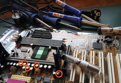

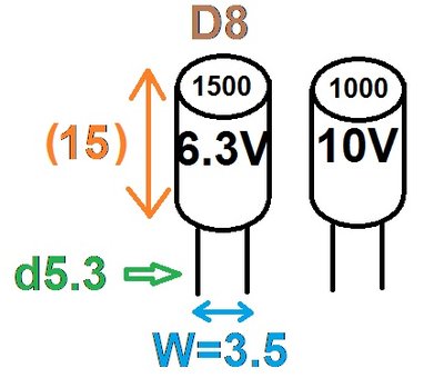

Reply 33 of 36, by user33331
I don't know we have now measured them with multimeter and measures were ok. Might as well try these "FR".
- 1500uf was 1600uf.
- 1000uf was 1100uf.
Board's cap specs.below and the board's 5 pcs caps are protruding.
These companies don't ship to private customers: Digi-Key, Farnell, Mouser,...
Tried to order but they called that not possible if *company field* is left empty.
- I bought some cheap LUX-Tools solder irons(30W and 60W) that came with D1.0mm Pb60 Sn40 solder(Pb=60% solder).
- Previously have some Stannol(15W and 30W) irons.
I added multiple Kapton-tape for protection to surrounding PCB-tracks. I'll try the removing when I have trained enough and I'm ready. 😵

Reply 34 of 36, by TheMobRules
Don't know about Farnell, but I have bought plenty of stuff from Digi-Key and Mouser as a private customer. You can always make up a fake company name if they require it... once, Digi-Key sent me a mail to inquire about the purpose of the stuff I had ordered, I guess they wanted to know that I wasn't importing components from the US in order to build a nuclear device or something. It seems these companies have to comply with certain government regulations and sometimes you have to play along with that.
In any case, I got Panasonic FRs with bent legs a few times from Digi-Key, so maybe yours are not counterfeit.
You will probably find that removing the old capacitors is actually quite easy, just heat up one lead and rock the capacitor to one side, switch to the other lead and do the same. Keep going until it's out, make sure not to keep your iron more than 2 or 3 seconds on each lead to avoid ripping the pad. Though on a motherboard they can generally take quite a bit of heat.
The difficult part however, is clearing the holes after you have removed the cap, that is what you should practice the most if you don't have a desoldering gun because it's where disaster is most likely to occur. Some people use braid (it can take several passes), others heat up a stainless steel needle as they jam it through the hole, and so on. Practice a bit and see what works best for you.
After you have cleared the holes, soldering the new caps should be a breeze. Just make sure you feed the solder through the hole so that it makes it to the other side of the board for a strong connection.

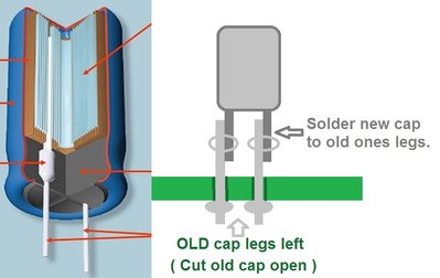

Reply 35 of 36, by user33331
I tried to remove 1pc capacitor with 15,30 and even 60W. 😵
I could not even melt the solder on cap's leg. ( Though the Pb60 Sn40 solder happily melted when presoldering the tips. 😊 )
The leg's solder stayed there and nothing happened.
Maybe I start saving for a desoldering gun China S-998 and similar.
*Edit
How about I cut off old capacitor's head with Dremel and leave it's legs then solder a new cap to the old's extruding legs ?
See photo. Could this work ?

Reply 36 of 36, by BushLin
user33331 wrote:
I tried to remove 1pc capacitor with 15,30 and even 60W. :dead: I could not even melt the solder on cap's leg. ( Though the Pb6 […]
*Edit
Just add a little new solder and use that to bridge the heat, makes a big difference. Flux helps too.
