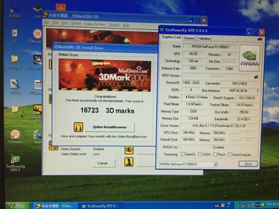

canthearu wrote:
I haven't really had a chance to do a full set of benchmarks on my Athlon 64-3800+, but I did throw 3dMark2001 at it (also using […]
I haven't really had a chance to do a full set of benchmarks on my Athlon 64-3800+, but I did throw 3dMark2001 at it (also using a FX5900XT card)
Video card stock - 17219
Overclocked video card (475 core/825 memory) - 18875
Just loving this build 😀 Although, if you feel I'm derailing your thread, let me know and I'll step back 😀

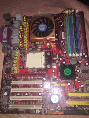

Reply 23 of 27, by Ponjiayulady
pete8475 wrote:
Is that a dual socket motherboard?
What's the model name?
Msi K8T Master2-far7, it can support single 940pin athlon fx or dual 200 series Opteron
The MB is very old, it can only support ECC registered DDR RAM, with very strange Intel socket 423/603 cpu cooler (Amd cpu but use Intel spec cooler)
Reply 24 of 27, by pete8475
Wow that is very strange!
Reply 25 of 27, by gdjacobs
pete8475 wrote:
The only unusual thing about it is the VIA chipset. Most dual Opteron systems of this era used AMD's workstation/server chipset (it supported PCI-X), then moved to nVidia in the PCIe days.

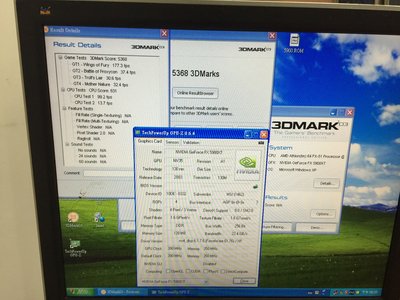

Reply 26 of 27, by canthearu
pete8475 wrote:
Benchmarks: Aquamark 3 - 38055 3dmark 2000 - 12723 3dmark 2001 - 14268 3dmark 2003 - 5156 3dmark 2005 - 1021 3dmark 2006 - 302 Q […]
Benchmarks:
Aquamark 3 - 38055
3dmark 2000 - 12723
3dmark 2001 - 14268
3dmark 2003 - 5156
3dmark 2005 - 1021
3dmark 2006 - 302
Quake 3 (1920x1080) - 224.3fps
More complete test run at stock (vs OP at stock)
Aquamark 3 - 38476
3dmark 2000 - 20451
3dmark 2001 - 17476
3dmark 2003 - 5428
3dmark 2005 - 1026
3dmark 2006 - 293 (had to place an extra 1gig ram IN, so I lose dual channel ram)
I don't have a HD screen connected to my retro test area so I can't test quake 3 at HD res quite yet
Reply 27 of 27, by pete8475

These are my most up to date benchmark results, using driver version 56.64:
Default clockspeeds
Aquamark 3 - 37397
3dmark 2000 - 13007
3dmark 2001 - 15299
3dmark 2003 - 5403
3dmark 2005 - 941
3dmark 2006 - 299
Quake 3 (1920x1080) - 233.5fps
Overclocked to 500mhz Core, 800mhz Memory
Aquamark 3 - 45939
3dmark 2000 - 13310
3dmark 2001 - 17344
3dmark 2003 - 6374
3dmark 2005 - 1164
3dmark 2006 - 354
Quake 3 (1920x1080) - 260.5fps
I'm going to try and squeeze a few more mhz out of the CPU, but during my previous attempts it was unstable above 3.5ghz in prime95.
EDIT - bumped the voltage up a little bit from stock and it's been running prime95 without problems at 3.51ghz.
