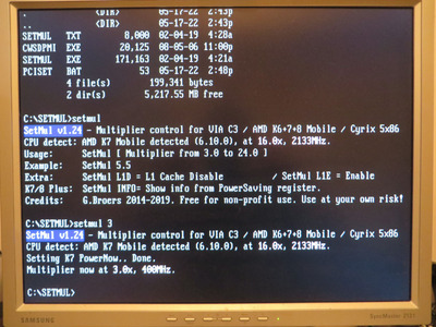

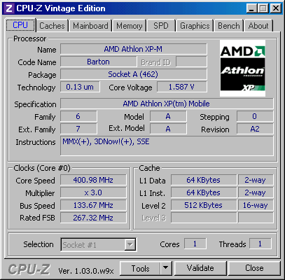

Reply 246 of 346, by mockingbird
Falcosoft wrote on 2022-05-17, 09:39:
Some corrections: In case of mobile Athlons 3x and 4x multipliers also seem to be valid but they can be set only at runtime/on the fly not from desktop motherboard's BIOS.
http://fab51.com/cpu/barton/athlon-e24.html
I can confirm, 3x multiplier is definitely possible with SETMUL:
383.53 KiB
1962 views
11.57 KiB
1962 views
Also, the Biostar M7VKD already has the correct register set for SETMUL adjustments in their latest BIOS.

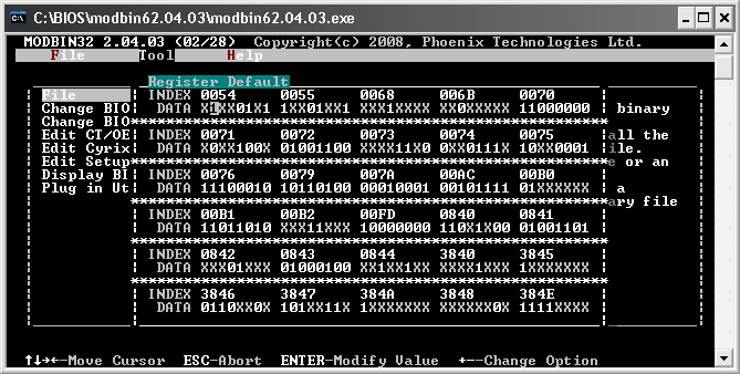

Reply 248 of 346, by mockingbird
ptr1ck wrote on 2022-05-17, 22:41:
mockingbird, do you know if modbin is capable of making the adjustments for SETMUL?
Yes, I think so:
11.07 KiB
1927 views
Alt+T then select 'Chipset Regs. Default'.
Thing is, I'm pretty sure it's entry "oo55" that needs to be altered, but I don't know how to alter it (or rather - I am able to modify it, but I don't know what to modify it to).
If you care to try, I'm happy to test it for you, because I have a first-gen TL866, so a mis-flash would be inconsequential.
Oddly enough, my M7VKD BIOS has no "0055" entry here at all... Another issue I was having with the M7VKD was it not always posting, and sometimes when it posts it shows a different BIOS than the one I flashed (I know when the correct BIOS loads, because the Bios Patcher text shows... When the phantom stock Biostar BIOS loads, it shows unknown CPU... That said, when it does usually post, the system runs perfectly fine -- still, I would hesitate to use this model on a regular basis).

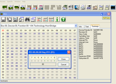

Reply 251 of 346, by Falcosoft
mockingbird wrote on 2022-05-18, 01:37:
I do not know the reason but according to your modbin screenshot the proper bit cannot be edited.
Based on this description
(https://web.archive.org/web/20170822100906/ht … html/Tweaks.htm)
you should set "reg. 55, bit 2 = 1".
Since there is also a part where it mentions that for AMD chipsets you should set "reg. 44, bit 0 = 1" we can be sure that it counts the bits of a register from 0 to 7. Which means that bit 2 is at the 3rd position counting from right. But there is a big "X" there (that means it"s not editable I think).
I have just checked and you can freely modify reg. 55, bit 2 at run time on KT133A
60.89 KiB
1888 views

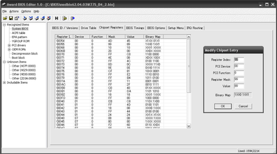

Reply 252 of 346, by mockingbird
Falcosoft wrote on 2022-05-18, 07:21:
<snip>
AWDBEDIT seems to be able to make this modification:
29.01 KiB
1869 views
But I can't figure out the correct Register Mask and Value combination that would get me 0000 0100 0000 0100 or "0000 1101" in short form...

Reply 254 of 346, by ptr1ck
mockingbird wrote on 2022-05-18, 15:24:
AWDBEDIT seems to be able to make this modification: […]
<snip>
The binary map looks like the same values as modbin with the bit showing X. I also want to make it clear that I'm not sure what I'm looking at. 🤓
