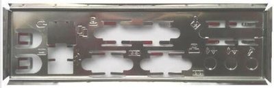

Reply 1 of 8, by melbar
This would be nice... 😉

Yes, the rear connector bracket would be nice, it actually came with the motherboard. But it did not fit well to the Compaq case, I guess they used slightly different measurements even though it basically is a standard ATX case. So I simply left it out because I didn't want to start cutting it.

Reply 5 of 8, by melbar
For my actual project, i have a slightly different problem with the I/O shield, but with the same result.
I cannot use a standard I/O shield, due to the little LED lights you can see between the serial port and the sound.
A standard I/O shield would not fit...
