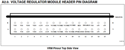

Reply 48 of 70, by gdjacobs
Kreshna Aryaguna Nurzaman wrote on 2020-08-27, 16:34:
Pardon the necro. […]
Pardon the necro.
I recently bought XVI 073-20742-30 VRM, whose output voltage is 1,3-3,5V. At first, I was happy with the specs, since its output voltage seems to be able to acommodate a wide range of CPU (AMD K6-2, being 2.2v, falls into the range).
But much to my dismay, the VRM's input voltage is 12V instead of 3.3V, and I cannot cancel my purchase.
So, will it work with my Socket 7 mobo?
The pinouts appear to be completely incompatible.
VRM header for Socket 7:
20.02 KiB
1001 views
VRM header for P2/P3 (rev 8.2):
25.71 KiB
1001 views
Getting the guts of that IBM module to work would likely be a significant job of re-engineering.
Reply 49 of 70, by Kreshna Aryaguna Nurzaman
gdjacobs wrote on 2020-08-28, 05:26:
The pinouts appear to be completely incompatible. VRM header for Socket 7: Screenshot_2020-08-28_00-23-18.png VRM header for P2/ […]
Pardon the necro.
I see. Thanks, buddy.
It seems every VRM I can found on ebay is 40-pin instead of the proper 30-pin suitable for Socket 7 motherboard (and I have to kick myself for forgetting to count the bloody pins before buying the item). Worse, 30-pin VRM are almost impossible to find. In fact, I haven't been able to find any.
