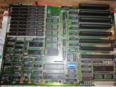

Okay, so I checked these caps for "anormal" resistance values.. I guess 0 and 1000000 is bad ?
If so, the good ones have between 395 (Ohms) and ~600 (Ohms) !? 😀

Update. I did a full re-cap and replaced the aging caps with ceramic and electrolytic types.
Unfortunately, no change. No VGA signal, no keyboard reaction.. 🙁

Do I see right on your photos that there is no display at all on the POST-card? It should at least display "--".
You still have some problems with the power-supply. Are you sure the POST-card is OK and its not causing the shortage?
Did you already test the voltages between a black wire (GND) on the power connector and the corresponding Pins on the ISA-bus? Maybe with and without the POST-card installed?

Thanks for the replies and tips!
The behavior of the mainboard is the same as posted earlier.
I checked with another PSU, too.
(Even replaced all the RAM caps)
Except for +12v (?), all other voltages are missing on the POST card.
I'm not 100% sure what this means, however. If checking the voltages on ISA, it seems they are there.
However, I'm afraid that doesn't necessarily have to mean anything,
because it doesn't say anything how the voltages behave under load (or how much current flows;
that's where the LEDs on the POST card would come in handy under normal circumstances). 🙁
PS: I've attached a current photo of the motherboard..

Reply 27 of 33, by Jo22
Predator99 wrote:
Are you sure the POST-card is OK...?
It seems to be. Tested in a Pentium 133.. I'll do soon in a 386, too.
Predator99 wrote:
Supersoft-ROM is a good idea, but without fixing the power problems it doesnt make sense to start with this...
Indeed. Programmed the EPROM, but no reaction.

Reply 30 of 33, by Jo22
I also tried without any expansions cards and with a Hercules clone (should work as MDA in Supersoft), but neither the PC speaker, nor the keyboard show any signs of life. 🙁

Aw, still no sign of life (with the diagnostic rom in place). 🙁

We resurrected my very broken XT motherboard (which sat in a damp garage for years and it was probably broken to start with) and you will find some information there on what to check. Your board is very similar. My motherboard was showing very erratic behaviour - one time it was looking like it's totally dead, but sometimes it would try to communicate something over pc speaker. I'm pretty sure you can repeat the steps described by Deunan in this thread and it will shed some lite on your motherboard.
Personally I would start with removing all RAM and putting good (checked) memory instead - as little as possible (256kB?). One broken dram chip in the bank 0 and motherboard will appear dead.
Also Ruud's diagnostic rom or ever better Landmark diagnostic rom is a must but you already know that.
Look for ICs (TTL chips especially) getting warmer than rest of them. Pull the EPROM and check if it's working fine in some programmer (TL866-II is perfectly suited for our hobby and I recommend it to every retro computer fan).
