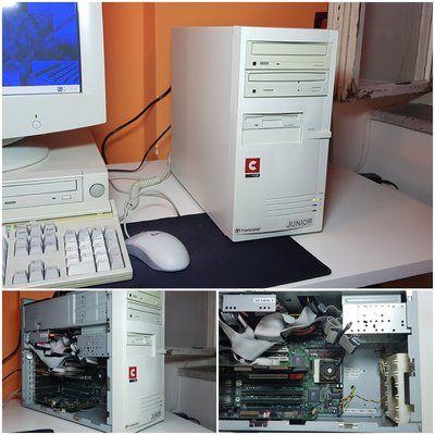

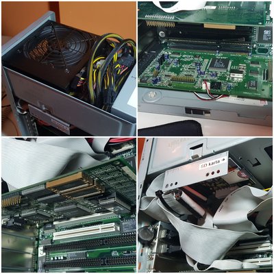

So I decided to not pursuit the dual booting and stuck with default Win95 boot. I went with S3 Vision864 PCI VGA card (4MB) for video and SB16 CT2980 for audio. Only trouble after that was figuring out the sound card's IRQ/DMA to set for each game and I am done!
Today I finished putting everyrhing to the original case. The case itself underwent some refurbishing - faceplate retrobrighting, new stickers (reverse-designed), a mount for SD-IDE adapter in place of original HDD and as a finishing touch, new thumbscrews for the cover. So satisfying....

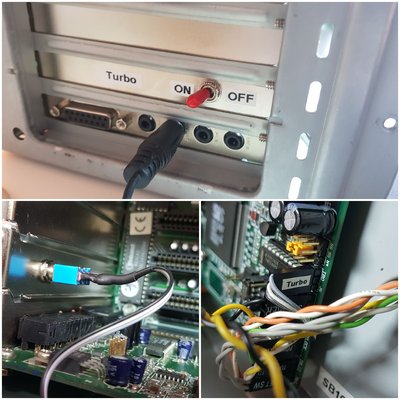

Made one final mod before handing it over...
The inherent lack of Turbo switch of the case was bugging me more than it should
687.54 KiB
368 views
