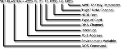

Reply 9 of 15, by Caluser2000
What model sound blaster? If its an early one try SET BLASTER=A220 I5 D1 T4. This page has a guide for various ISA SBs https://nerdlypleasures.blogspot.com/2010/06/ … d-blasters.html On that page the IRQ is set to 7 which is usually the 1st lpt port for sound cards 5 is normally used. Also some games have a *.cfg file, just delete it.
SET BLASTER guide:
12.99 KiB
380 views
For PORT ADDRESS, it's almost always 220. That seems to be the default for most sound cards out there, and unless you know you've switched it away from 220, it's a safe bet it's still there.
The INTERRUPT is something that varies from system to system.
The DMA CHANNEL sometimes causes problems if it isn't set to 1, which is the usual default. If it is not set correctly, some games may lock up when the sound is turned on.
The TYPE OF CARD should be 1 if you have an older Soundblaster, or a Sound Blaster emulating card. Use 3 if you have a newer plain Soundblaster. Use 2 for an older Soundblaster Pro. Use 4 for a newer Soundblaster Pro.
The MIDI PORT parameter will only be needed if you are using a card that has MIDI capabilities. If so, this is where you define what MIDI port you are using. 330 seems to be the default, so if you have a MIDI card, and you haven't changed anything from factory defaults, this is probably where it still is.
The HIGH DMA CHANNEL is something that is used primarily on Soundblaster 16 cards. This is not the same as the standard DMA channel, this is a different one. This is only used if you're using a 16 bit sound card capable of playing 16 bit Soundblaster sounds. By default, this is usually 5, so unless you know that it's something else, it's probably still 5.
The E620 parameter is something that is needed _only_ if you have a Creative Labs AWE 32 sound card. If you have one of these, this parameter will have been set up properly assuming you've installed the software that came with the card. Check your AWE 32 documentation for a more thorough explanation of what this parameter is used for.
