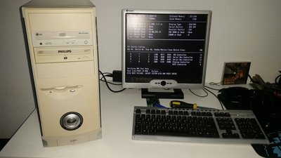

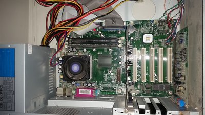

Hi guys
I picked up three PCs at the car boot this morning including this one
QDI Advance 10T
Celeron 900MHz (068A/01)
CGA-76032DTVD Radeon 7000 AGP
SB16 ISA soundcard
A bit of googling did not find any drivers or manual for this.
Actually when I saw it I thought it was an old Socket 7 or similar as it has an ISA slot and I didn't think they were still present on Pentium III type machines. It is complete apart from the HDD is missing, and it seems to be working though some of the caps obviously want replacing as they are bulging.
Does anyone have a reputable link to the drivers for this motherboard? What happened to QDI did they go bust or get taken over or something? I used to buy directly from them in the 90s and built a lot of PCs using their motherboards.
Anyway this looks like it could make a good Win98 retro gaming machine. Would it run DOS games too, seeing as it has an ISA sound card fitted?

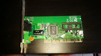

Also as an aside it has a PCI LAN card with an Eprom socket. Can I do anything fun with that socket?

The QDI Advance 10T is a very good Tualatin motherboard. It's fast, reliable and uses quality capacitors (Rubycon). It's actually the motherboard that resides under the bonnet of my overclocked 1.4 Tualatin-S daily driver, XP runs great. As Warlord pointed out, you should pick the 4-in-1 4.43v as they are they are the ones that provide the fastest performance for your system. Although remember that overclocking via BIOS is very limited on this motherboard, so if you want to do it, you need to do it via software and pick the Cypress W311 as a PLL, since it seems to be the most compatible with that motherboard.
If you like to fiddle with your system to make it as fast as possible, you can also "hack" the chipset with a program called WPCREDIT in order to access the memory registers directly and enable 4-Way interleave in order to let your RAM run at 2-2-2-5 speed. With an A10T, a Tualatin-S, a SATA controller card hooked to an SSD or a 10.000RPM HDD, you get a very fast Windows 98 and XP machine. I'm posting this reply from my very Tualatin PC, which I'm happily using as my main system since two years... 😉

Hey thanks for the info - and thanks to the advice here i should find the drivers I need. I think some of the capacitors looked rather iffy but will check them out properly under magnification at the workshop tomorrow. I picked this PC up cheap today, 8 euros at the flea market so probably a good buy, even though I thought it was a socket 7 😊

For the ROM socket on the NIC, it was for a PXE bootrom (wasn't exactly PXE but rather an ancestor of PXE so to speak, I don't specifically recall what it was named), it's not very useful that is, unless you wanna slap an XT-IDE BIOS (to bypass for exemple a BIOS hdd size limit), you could put it on a EEPROM then place the EEPROM onto the NIC's ROM socket...
So yeah.
