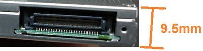

Hello
Searching for a laptop cd and\or dvd drive which is 9.5mm thick and has a standard JAE-50(="Slim IDE") connector.
- Usually they are 12.7mm thick.
- Thinkpads'=T60,T61..."Ultrabay Slim"-drives like UJ-862 are no good because yes it is 9.5mm thick but it has a custom security connector which is not JAE-50 but similar.
Apple Macbook has one but it is slot-load and no bezel:
- UJ-857, UJ-867.
These are maybe: ( Got to look more...)
- UJ-842.
- GSA-4083N.
Also laptop's model might be more important than drive's code when searching.
- If anyone has a huge lot of laptop optical drives around to check.

I think you've listed them all pretty well there.
I have a couple, you want to look at early PCIe era laptops. The Sony Vaio SZ series all had them, I think the UJ-852, but they had quite a non-standard bezel.
I removed one from an unrepairable vaio TX laptop the other day. That's also 9.5mm height, tray load with a bezel, but it's very thin and has no top cover / frame. That's the UJ 822.
The GSA-U10N is a good choice, the thin HP laptops from back then had them and I've got one here with a fairly standard bezel on it. That should be the HP Compaq 2510p
