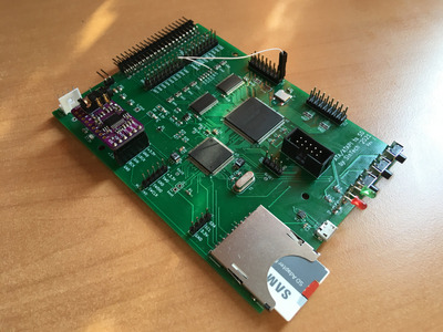

Hello guys!
I'm an author of ATA/ATAPI2SD emulator. I saw some traffic from vogons on my YT videos so I searched and came here.
Actually this thread inspired me to begin my project in the first place. I also was long curious about ATA (ATAPI) protocol and wanted to know how it really works, so I decided to make my own emulator.
But instead of making heavily specialized device I wanted to make a versatile gadget to cover most (if not all) possible scenarios.
This is the list of initial features that I wanted to implement:
  • Emulation of ATA HDD of any size with CHS or LBA translation
  • Emulation of ATAPI CD-ROM. Support for analog output of AUDIO tracks. SPDIF-out as an option.
  • Emulation of other ATAPI devices like Iomega ZIP, MO, etc.
  • Support for transfer protocols: PIO, MW-DMA, UDMA.
  • Support for host mode where ATA/ATAPI drive is connected to emulator for device id dumping, sector viewing, making of drive image.
  • Storage for images: SD-card. No requirement to convert images to some special format.
  • USB interface for configuration and debug output via emulated serial port.
  • Ability to connect generic OLED I2C screen for status display (as on Gotek)
  • Minimum three physical buttons to select image or change settings.
  • Ability to work with very old computers as well as with modern computers or devices.
  • Compact size to fit standard 3.5" bay.
As of today I have done most of this among a lots of other things.
The most important new feature is a support for two emulated devices on the same cable which could be selected from any combination of ATA/ATAPI drives.
My approach for drive emulation is based on real device id info extracted from real drives, so it is not some generic "ATAPI emulator", but a real clone of any ATA HDD or ATAPI CD-ROM at least from the point of ids and capabilities saved in device id dump. Thereby emulated drive and image are a two different entities. When HDD image is loaded to some drive, device id is updated to match image size and transfer mode limitations.
Emulator has confirmed support for Iomega ZIP-100 and ZIP250 drives.
Another interesting feature is an ability to override device id data using per-drive config files. In other words, you can change any option you want on per-drive basis, for example change CHS parameters or serial number to match some specific piece of hardware.
On current board I use PCM5102 I2S DAC module for analog audio output. My MCU supports direct SPDIF output but it is not implemented yet.
Picture of rev1 proto board:
1.59 MiB
4272 views
Reply 271 of 498, by SScorpio
sintech wrote on 2021-10-26, 21:07:
Hello guys! I'm an author of ATA/ATAPI2SD emulator. I saw some traffic from vogons on my YT videos so I searched and came here. […]
Hello guys!
Welcome, and please keep us posted on any progress.
Your project looked exciting from what was shown in the video and what Google Translate was able to not mangle. But seeing all that spelled out is very impressive.
Reply 272 of 498, by SpocksBeer
