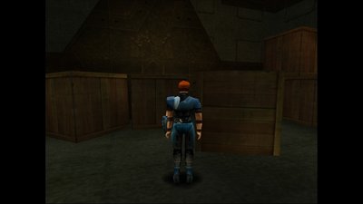

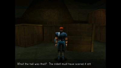

Omikron: The Nomad Soul with resolution forcing (1080p) makes game blurry and pixelated (only when text appears, like subtitles), when there are no text - forcing higher resolution works as intended!
pixelated (when text or any UI shows)
161.53 KiB
2249 views
not pixelated (when screen is clear)
128.49 KiB
2249 views
