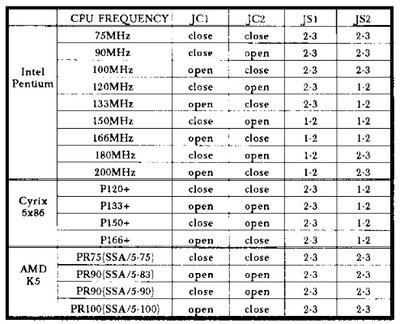

Reply 6 of 7, by user33331
Ok. It was the older Explorer I (one) afterall.(with Pentium 120 MHz)
So AMD K6-I: only "200 Mhz" from 1997-98 is the fastest ?
No jumper settings above +200 Mhz ?

Reply 7 of 7, by The Serpent Rider
Pentium MMX 233 interprets 1.5x multiplier as 3.5x.
AMD K6-2 interprets 2x multiplier as 6x (only "Chomper" version) and 1.5x as 3.5x
I think Cyrix M2 behaves the same way, i.e. 1.5x = 3.5x.
