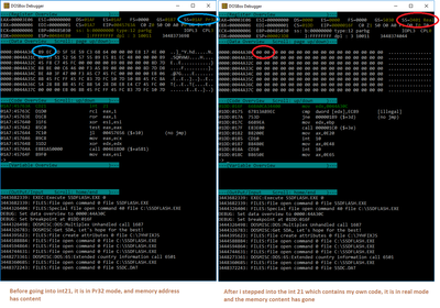

Reply 42 of 44, by secmaster
I am doing the similar loader as what Akuma did
However, my problem is that the executable I am working will sometime go to protected mode and
it will use dos extender to write the memory into address greater than 1Mb
I built the loader with nasm and running in real mode (16bit) add modified the interrupt 21h to add my own code (i.e. changed the int vector of 21)
I can see from dosbox debugger that my code is running, but it is in real mode, all the memory content I want to check from the executable is gone (as it is marked in protected mode)
Please can you shed some light how can i access the memory in real mode? Or i need to switch to protected mode? (it seems very complicated for newbie like me)
p.s. the memory address I want to check is at 0x0044a30c

Reply 44 of 44, by secmaster
Akuma wrote on 2021-09-10, 14:53:
This is beyond me, however there must be process that swaps the memory around. My first bet is to figure out what that is and hook into that.
Thanks Akuma, i tried to use unreal mode, but without luck.
Not sure what else can do
