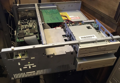

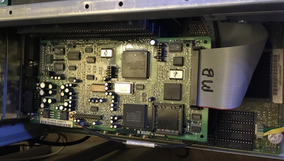

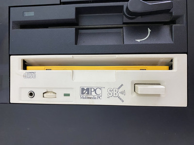

Hi, I have an Sound Blaster 16 CT1740 card with an IDE interface.
I think this was a Sound Blaster kit with Sound card and CDROM.
The CDROM is a Sound Blaster proprietary with jumper that read 0123 ( No master or slave or cable select )
It is NOT SCSI , It is a 40-pin IDE drive.
Not sure what speed.
Model - Matsushita CR-563-b
The CDROM appear to functional but I am not sure because I can’t test it.

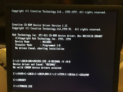

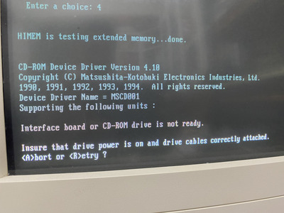

So I obtained a install diskette for the Creative CDROM. It uses the SBIDE.SYS driver.
I ran the install program and all went fine but the CDROM is not being recognized.
Any Ideas why it’s not working ?

I am using
Autoexec.bat
MSCDEX.EXE /D:MSCD01 /L:G
Config.sys
DEVICE=CDMKE.SYS /D:MSCD01
But the CDROM is not being detected.

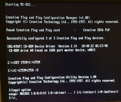

I doubt you had a CT1740 working with an IDE CD-ROM drive, the CT1740 comes with a Panasonic/MKE interface only.

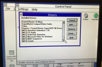

Also, you posted a screenshot of the initialization of a SB PnP card, which cannot possibly be a CT1740 as this model is non-PnP and must be configured with jumpers.
I recommend you take a picture of the sound card you're using because it's not really clear based on your posts.

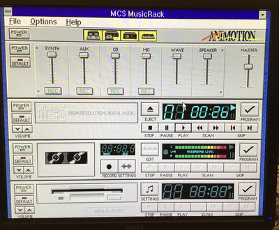

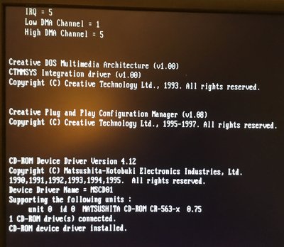

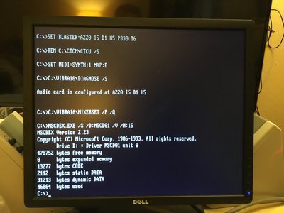

Yes, it works with games and music.
I use these settings to get CDROM to work.
I also had to install the Sound Blaster 16 drivers.
Autoexec.bat
MSCDEX.EXE /S /D:MSCD01 /V /M:15
Config.sys
DEVICE=CDMKE.SYS /D:MSCD01 /SBP:220

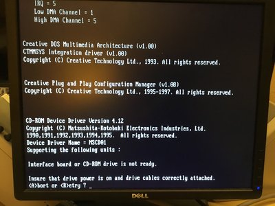

I also have CT1740 and CR-ROM drive, but can't have it work via SBCD.SYS or CDMKE.SYS. Can you share the configuration files?

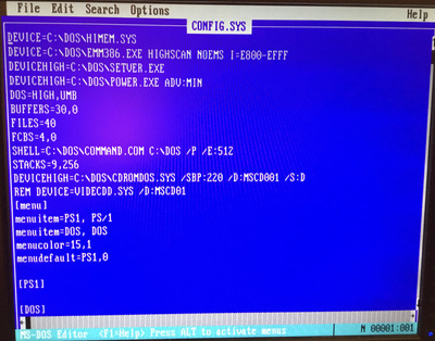

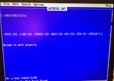

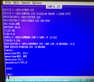

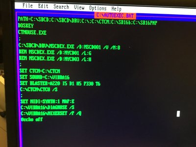

Reply 16 of 19, by Intel486dx33
Okay here are some photos of my config files.
I have a custom config file because it is part of the ibm original install
But just don’t add the ibm ps1 lines to your files.
I am running dos 621 and using a driver file called “CDROMDOS.SYS”

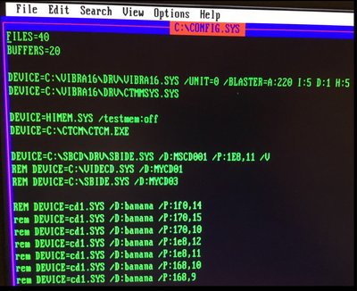

Reply 17 of 19, by Intel486dx33
More photos
Reply 18 of 19, by Intel486dx33
