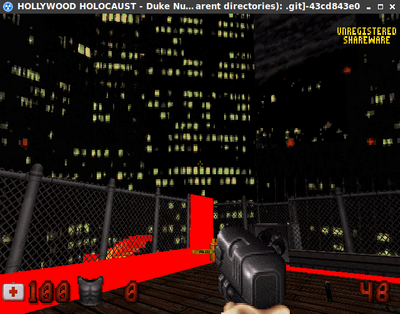

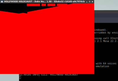

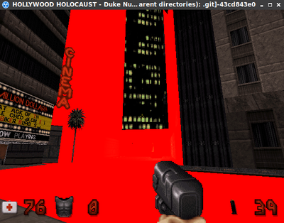

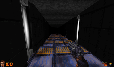

It is either black windows with Software renderer or red window with Polymer/Polymost.
eduke32 as is works:
27.85 KiB
2134 views
but all I get are untextured red polygons with some errors. Gameplay works though (just don't see it).

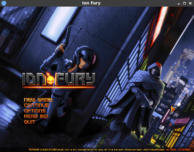

Problem is probably here. Game engine (Polymer) works but it has black untextured polygons (or red). Great. Now what?

Ok I see problem right now. It's actually complaining about it:
glTexImage2D(internal_format=GL_RED) - invalid operation
GL_RED isn't allowed argument for internal_format as far allowed by OpenGL2.
I guess same thing for glTexSubImage2D().
Ok, so now what? Report it, leave it be or should I just rewrite glsurface.cpp right now to be OpenGL2 compliant?

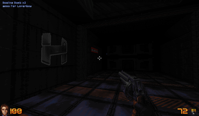

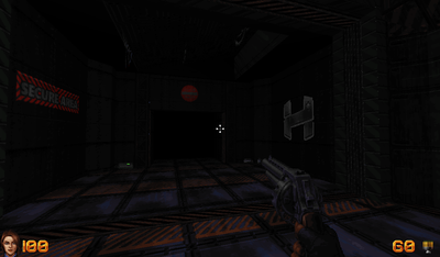

On eduke32_20211006 and little tweaking, I've been able to get Polymer running even on OGL2.1 compatible graphic card. But it is no fun:
158.54 KiB
1830 views
196.63 KiB
1830 views
21.25 KiB
1830 views
289.85 KiB
1830 views
It is slow (CPU intensive), full of graphical glitches and corruptions. Ion Fury is more like slideshow and with first level I've been able to crash cards core. But it is relatively new eduke32 and it works (SLD2 + SDL1.2). I'm happy.

Make your games work offline
Reply 117 of 132, by Grunt
Guys, I don't get how you were able to get Ion Fury running on…well, on anything.
I just finished reading whole thread and to address first obvious thing: There is a reason why Ion Fury has been released as 64-bit, SDL2 compatible binary. It was built on eduke32 engine, but Ion Fury is pretty much modern game on older base. So don't let the appearances fool you. By profiling the thing, I just discovered there is Virtual friggin' Machine! And you may not notice on regular modern dual-core CPU it's presence (as modern CPUs are designed to swallow instructions), it is very first thing on gprof list, profiling eduke32 on old 1,6GHz (45 nm) single-core Diamondville Atom. I don't know how it got there and when, but it is simply there.
I've been able to to execute eduke32 + Ion Fury just barely. First thing is to load small map (don't start with z1m1.map, guaranteed way to crash), next is to disable monsters (-m startup parameter).
As soon as I look into map and engine has to traverse through all portals/sectors (on BSP engines it is software BSP tree traversal, no idea how it is done here), looking gets jerky. And as soon as I wake up monsters (or actors or whatisitactualy),it is pretty visible as engine has to go through entire thing and updates states just once per second or even less with CPU on fire. Surprisingly original duke3d works pretty fine, but load bigger complex map and guaranteed it will get older CPU to knees. This is why I don't get how you may be able to get this thing working on Win9X or let aside DOS. Nonsense. Not modern eduke32 git trunk.
eDuke32 contains not two, but four "Video rasterization modes":
  • Polymost - I haven't been able to get it working as all I still see are either red or black screen. Bummer. Some OpenGL bug I assume.
  • Polymer - works with bugs and glitches (see screenshots) and it consumes even more CPU than software mode (all palatalized textures has to be converted and updated to GPU, not very effective I guess). On the other side, it doesn't matter which screen resolution I choose and it works pretty good even in fullscreen. And as soon as CPU is able to fill polygons quickly enough (very rarely in my case), it's smooth too.
  • Software renderer on OpenGL canvas - bugged in my case. All I see is one channel (red), four times and resized in SDL windows. Just some texturing bug. Didn't bother further as OpenGL canvas is slower than just pour pure pixmaps.
  • Software renderer directly to SDL - binary has to be compiled with "USE_OPENGL=0". Surprisingly faster than anything as long as window is small. But I guess software rasterization has to take some CPU cycles too and of course price is no perspective correction. Should work on anything as long as SDL is able to initialize. Tested od SDL1.2/SDL2.
176.04 KiB
1726 views
156.56 KiB
1726 views
136.94 KiB
1726 views
239.71 KiB
1726 views
321.11 KiB
1726 views
Screenshots directly form EEE PC in fullscreen (1024x600 pixels) and OpenGL mode.
I wish I could see Ion Fury on some handheld PC or older HW and I'm going to do some further testing and profiling, but since I'm no expert in the field of VM optimizations, I think I might be done. If you still decide to optimize eduke32 somehow, let me know. I'm interested (if nothing, at least in testing).
