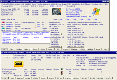

I found an S3 Trio64V2/DX in a box and after reseating the memory chips managed to get it working so added support to SIV.
I also added support for the Trio32 + Trio64 + Trio64V+ which I can't test, so if you have any of these cards it would be great if you posted a screen shot similar to as below.
I have only tested on NT4, but things should also work on W9x/WMe/W2K/WXP. The panel is Menu->Machine->GPU Info.
file.php?id=70606
I plan to add support for other S3 GPUs and if you would like to help post a screen shot of what SIV 5.42 Trio-01 currently reports.
    44.29 KiB
    818 views
    SIV reporting an S3 Trio64V2/DX

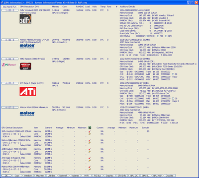

Reply 217 of 1037, by red-ray
xjas wrote:
Unfortunately I was hoping this would just be a 'just boot the CD & test' solution, but it doesn't seem to work that way. Mini-XP uses a bunch of generic drivers for hardware (such as the GPUs) so it doesn't show any info. Oh well.
Thank you for checking out SIV on Mini-XP. Thinking about this I should have realised they the GPUs would not get reported, even with the Windows 10 pre-install environment you only get one GPU.
As it turns out it was a rather good test anyway as the system has a very small paging file which caused several of the SIV memory allocations to fail! As SIV kept working this means the error recovery paths worked as they should.
xjas wrote:
The ALR 7200 board is a bit buried, but...
I know the feeling, I have several boxes containing spare bits and pieces some of which I had forgotten I had!
I have never really tried to get multiple GPUs working on 98 and also find W2K struggles. WXP and later in general are OK, but my TYAN S2466 is being a pain, when I install the 6th GPU it reports it does not have enough resources on both WXP and 2003 Enterprise Server 🤣
file.php?id=70625
I can't find an ATI Rage logo I like the look of
    99.65 KiB
    787 views
    Only 5 GPUs
