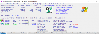

Finally getting back to this! I've been doing some testing with my (upgraded 😉 ) K6-2+ system. Just tried out the newest 5.45 Beta2. It seems to do pretty well, but I noticed a couple minor things are getting misreported:
The new CPU is a K6-2+/550 ACZ (link). SIV reports it in most places as a K6-III (Sharptooth). There are a couple of lines where it shows K6-2+ in the saved report. It does get the L2 size right at 128kB (a K6-III would have 256kB.)
(Note: CPU-Z seems to share this behavior, it shows a 2+ on the main screen but as a K6-III on the benchmark screen.)
I've got it running at 5.5x105=577.5 MHz, a mild FSB overclock. SIV seems to be interpreting this as 7x82.5 instead (and also shows the RAM speed as 82.5MHz because of this.) It does report the RAM TIMINGS correctly, at 2-2-2-6-9 (agreeing with CPU-Z.)
Also, I don't see any indication of the L3 (motherboard) cache. Does SIV check this?
This system has my other Voodoo3 (a legit 3000 running at 166MHz) in it, and everything seems to be OK there.
The CPU temperature is fine on the main screen. In the Status window, 'T2 System' and 'T1 CPU' seem to be reporting OK, but there's a 'T3 AUX' that shows -48 C. I don't know what this sensor is, to be honest. AFAIK there's no actual temperature sensor in this CPU so I presume 'T1 CPU' is taken from the sensor in the socket?
Voltages, etc. are all being reported correctly as far as I can tell.
Report attached. 😉

xjas wrote on 2020-01-12, 10:50:
AFAIK if 256KB then AMD-K6-III+ else if 128KB then AMD-K6-III else AMD-K6-2+ and given the CPU reports itself as "AMD-K6(tm)-III Processor" this is also why SIV reports "AMD-K6-III (Sharptooth)". When SIV reports "K6-2+" this is down to the data SIV is reporting from not reporting the L2 cache size.
It would be easy enough to change the code, but before doing this I need to convince myself what should be reported. Do you have an AMD document that specifies this?
This is down to SIV not reading MSRs on W9x and on NT/XP it should report correctly, does it? Either way 5.45 Beta-03 should do better on W9x.
SIV did not have the concept of L3 Motherboard Cache so I have added this for 5.45 Beta-03.
As SIV does not know the motherboard model it fails to suppress T3 and on NT/XP it should not be there. Is the motherboard maker and model within the W9x registry and if so where please?
file.php?id=74344

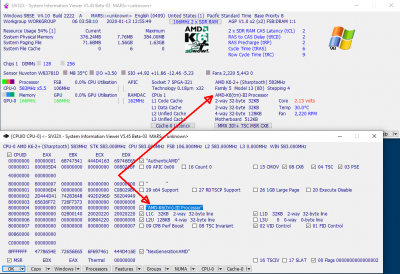

xjas wrote on 2020-01-12, 21:42:
red-ray wrote on 2020-01-12, 12:08:
The CPU reports itself as "AMD-K6(tm)-III Processor" this is also why SIV reports "AMD-K6-III (Sharptooth)".
I didn't look at every single one but at least the 'standard' (original) K6-III is definitely a 256kB chip.
The AMD-K6(tm)-III Processor is down to what the CPU reports and I am unsure what to do about this. I wonder if it's down to a BIOS bug and if there is an updated BIOS that fixes this, what do you think please?
file.php?id=74448
    94.88 KiB
    1343 views
    CPU reports itself as AMD-K6(tm)-III Processor

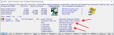

debs3759 wrote on 2020-01-15, 01:18:
For CPUID 05Dx
if x = 0-3, it's a K6-III+
if x = 4-7, it's a K6-2+
Thank you, I was not aware the K6 designation could be derived from the stepping. When I checked the SIV save files I have it seems to work, but noted the CPU reports itself as a K6-III rather than a K6-III+.
file.php?id=74596
    52.11 KiB
    1303 views

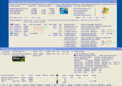

For SIV 5.45 Beta-10 I added GeForce 6000 series direct clock + fan PWM % and NVCPL temperature reporting for ForceWare drivers. The ForceWare drivers don't support NVAPI and are typically found on Pentium M laptops.
I would be particularly interested to see what get's reported for a GeForce 6000 with two fans.
file.php?id=75870

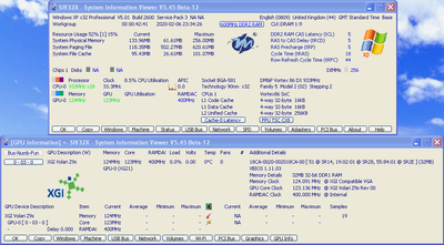

Reply 276 of 1037, by red-ray
For SIV 5.45 Beta-12 I added XGI Volari GPU clock speed reporting. If you have an XGI Volari GPU please post a screen shot similar to as below so I can check how well the new code does.
file.php?id=76256
I also fixed a few small glitches in the DMP + RDC CPU support. You need to SIV 5.45 Beta-12 or later which is attached to SIV support for 386/486/586 class + Alpha CPUs and 3dfx + S3 + SiS + Matrox + XGI + old ATI + NVidia GPUs - Testing Help and things should work on all of Windows NT/2K/XP/9x and later.
    103.85 KiB
    1223 views
    DM&P Vortex 86 DX + XGI Volari Z9s

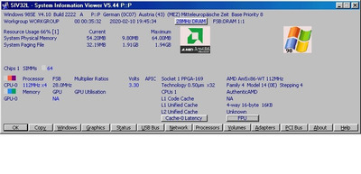

I did not know SIV - System Information Viewer before I found this forum, it seems to be good, tons of information available. Must try it out on a normal hardware to see what it can do.
But first 2 screen shots from my antique Micronics ASIC Eisa 486 computer with (newly setup) Windows 98SE. I just tried hwinfo before, so now SIV, will also try cpu-z 😀
The mainboard only has EISA slots, so only ISA and EISA cards are possible in this computer, I don't know if that is interesting for you, it is likely relevant only for 0.0001% of the users.
I ran the siv32l.exe v5.44, works fine, no crashes.
58.23 KiB
1193 views
36.34 KiB
1193 views

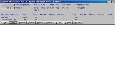

The gpu detection is not too exciting, what's nice is that all video modes possible of the ATI Graphics Ultra EISA are reported.
For the CPU the external bus is reported with 28MHz, but it should be 33MHz, so also the cpu speed is wrong only 4 times 28MHz. The external cache of 256kB on the mainboard is not detected.
Also no harddisks are detected, most likely because of the EISA bus.

CoffeeOne wrote on 2020-02-10, 19:37:
Thank you for trying out SIV and given I don't think SIV has ever been run on an EISA system then it did OK, at least it did not crash.
In general SIV uses the PCI Device ID for GPU reporting which will not be present, that said it does report my Kelvin 64 ISA GPU so I suspect I will be able to improve what it reports for your GPU. To enable me to do this do Menu->File->Save Local and post the generated save file.
The 28MHz is down to the CPU speed being measured as 112 MHz, so I suspect I need to adjust this. Please will you post Menu->Help->Conversions->CPU MHz so I can check.
SIV does not report Disk SMART on Windows 98, but will if you can run Windows NT 4.0 SP6a. As I recall HWiNFO is the same.
