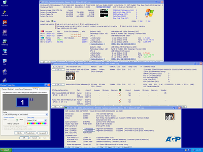

Reply 13 of 21, by red-ray
I had not booted my Socket A system in a while so I thought I would install a 3dfx Voodoo 3 and see what happened. Below you should see it "just worked".
file.php?id=67799
    192.26 KiB
    526 views
    Dual Socket A + 3dfx Voodoo 3
