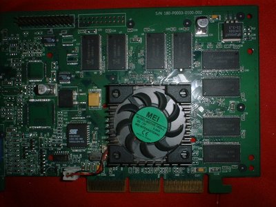

I'm just going through my box of old graphics cards and came upon one that has me puzzled.
No idea where it came from originally ...
Is green pcb ..and by NVIDIA ( logo on solder mask) AGP
Fitted with a green label MEI fan
VGA only out -15 pin
8 chips (ram) VG3617161DT -6
..and the only extra info on the board is - elec1G-02b revA00
anyone ?

Reply 11 of 17, by Doornkaat
I'm puzzled as well. The datasheet describes the VG3617161DT -6 as 16Mb SDR RAMs. Eight of them make for 16MB. Obviously it's a 6ns part so they are specced for up to 166MHz. What Nvidia card has 16MB of 143-166MHz SDR memory? Also with 8 of those chips the card probably has a 128bit memory interface. This leaves a Riva TNT with very fast memory, a Riva TNT (Pro), GF256 SDR, GF2 MX (400) or a GF4 MX 420/440 SE with only 16MB or memory. None of those cards make sense so I guess we have been presented with incomplete information.

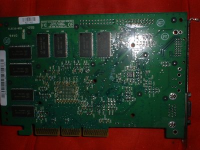

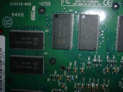

Just been home and grabbed the card ..flipped it over and exposed more ram ..
another 8 on the reverse.
It does help to actually have it in hand instead of trusting to memory.
pix attached
rgds
VS

Reply 15 of 17, by Doornkaat
GeForce 256 32MB SDRAM.
The three legged transistor plus the capacitor in the right upper corner are really characteristic for the reference design of both the SDR and DDR variant of the GF256. 😀 Sets it apart from the GF2 GTS and all TNT2 that might look similar at first glance.
Keep it. 😉
