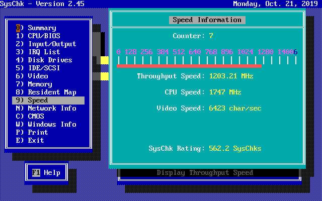

I thought I might post this, as it seems kinda weird.
6.98 KiB
1726 views
64-bit MSVC2019 core=dynamic cycles=max

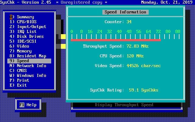

64-bit MSVC2019 core=dynamic cycles=3000
core=dynamic cycles=3000 (default)

At "max" syschk just takes forever to get through the video test. The first 3 seconds or so fly by and then it just goes slow enough to see the text scroll.
