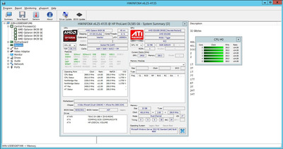

I ran latest hwinfo beta (from the website) on a HP DL585 G6
177.2 KiB
762 views
Some minor issues 😀
I started it in debug mode and attach a report
    hwi_625_4135-dl585g6.7z
    39.69 KiB
    36 downloads
Reply 217 of 683, by Mumak
CoffeeOne wrote on 2020-04-13, 15:12:
I ran latest hwinfo beta (from the website) on a HP DL585 G6 […]
Some minor issues 😀
Thanks! What issues do you see? SMBus devices is locked there by BIOS and we don't know how to enable it due to lack of NVIDIA documentation, hence no memory module details.
Reply 218 of 683, by CoffeeOne
Mumak wrote on 2020-04-13, 15:21:
Some minor issues 😀
Yes, it's ok.
But how can Ray's siv know that there are 8 DIMMs in the machine?

Reply 219 of 683, by Mumak
CoffeeOne wrote on 2020-04-13, 15:27:
Yes, it's ok. But how can Ray's siv know that there are 8 DIMMs in the machine? EDIT: Maybe hwinfo knows it, too. But where it i […]
Some minor issues 😀
Yes, it's ok.
EDIT:
Maybe hwinfo knows it, too. But where it is shown?
From SMBIOS DMI. That's shown by HWiNFO too, but not included in the memory modules list as this kind of information is sometimes not reliable (some BIOSes don't populate it correctly).
