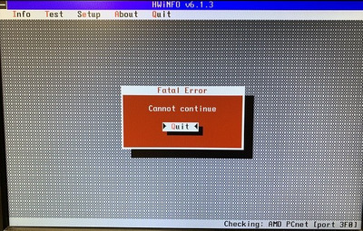

I tried running as "HWiNFO -r -d logfile.txt" and got this error:
124.4 KiB
1735 views
It exits gracefully after error.

Unfortunately the attached DBG file doesn't capture the screen where it crashed.
But it's quite strange as that test is just a simple read from port 0x3FE. Do you know if there's something in that range?
Reply 507 of 683, by douglar
I had the debug file that didn't have the "-r" switch. Here's the larger file. Still doesn't have much in it.
I only had an IDE controller and a VGA card in the system. I changed to the ISA Trident VGA card I used when troubleshooting and got the same error.
I wish I could find the MR-BIOS for the chipset.
