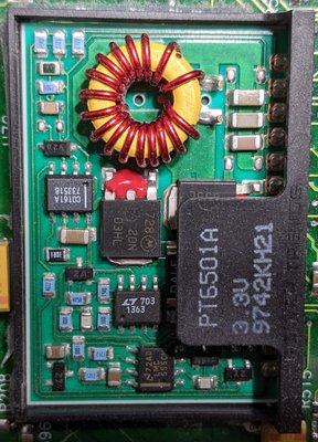

cyclone3d wrote:
I think the power trends module is the voltage regulator for the CPUs? 😕
It should be a VRM for supplying the 2.8v core for cpu's, it might also supply the 3.3v cpu periph as I do not see any Vregs on the board itself.

Soooo... got the system I ordered today.
The bezel survived! 😀
The L2 cache is indeed 512KB with the COAST module installed.
There aren't very many options in the BIOS at all.. but:
There is IDE support in the BIOS so I bet just populating the IDE header by the power headers will give us working IDE.
The DALLAS chip is not dead. I wonder how much longer the original will last for.
The power switch is an actual on/off switch and not just a temporary switch. I'l verify later tonight but that is definitely part of the reason why I couldn't get the spare board to power up.
I'll also map out the connections and post them.
I'll also weight the system.. expecting about 36 pounds.
Last but not least, the voltage reg module in this system came with the cover removed... so it looks easily serviceable if something messes up in the future.

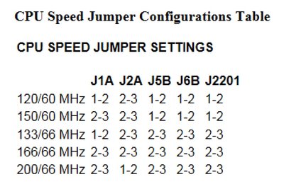

Reply 46 of 394, by PC Hoarder Patrol
Think there are 4 multipliers, dependent on which cpus are installed - 1.5, 2, 2.5 & 3. 100MHz chips aren't covered, but the NEC table is more complete than the ZDS one
179.9 KiB
1061 views

Reply 55 of 394, by cyclone3d
Here is the layout and configuration sticker form inside the case.
929.87 KiB
969 views
I wonder what the reserved jumpers do.
I did a little bit of testing to figure out the undocumented multiplier and fsb settings:
Multiplier is J1A and J2A
1-2 1-2 = 1.5
1-2 2-3 = 2
2-3 2-3 = 2.5
2-3 1-2 = 3
fsb is J5B and J6B
1-2 2-3 = 50Mhz
1-2 1-2 = 60Mhz
2-3 2-3 = 66Mhz
2-3 1-2 = no POST - guess this is the test mode?
J2201 doesn't seem to affect anything. Probably need to test the different positions when benching. Maybe it is for some wait state or divider. It is right next to the RAM slots.
